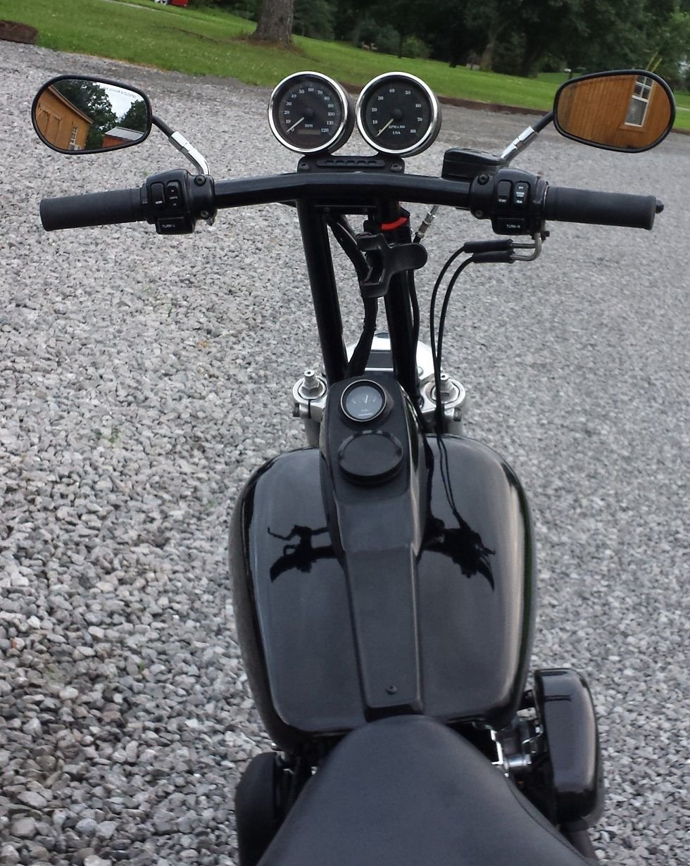

I see you got 2 gauges set up will that bracket work with mine my bike is currently set up like this
That doesn't look like T Bars to me.....

I know I don't have tbars on right now I'm ordering them but need to know how I'm going to mount my speedo to them

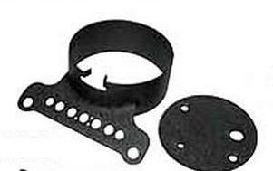

There is a single gauge mount that is just like my dual gauge setup (I have one out in the garage somewhere)
Obviously the one you have won't work with T-Bars but you can get one of the single mounts to use with your setup.
I might even let you have mine if you want to pay for the shipping, 'cause I'm never gonna use it.

The one I have looks exactly like this one.....
You will need an acutronix tbar bracket with that. The tbar bracket mounts to the riser and the gauge mount attaches to the bracket. If you use a combination of risers and bars you can attach the above gauge mount directly to the top plate of the risers. I did not do this because the riser bolts are not offset like the stock risers.
