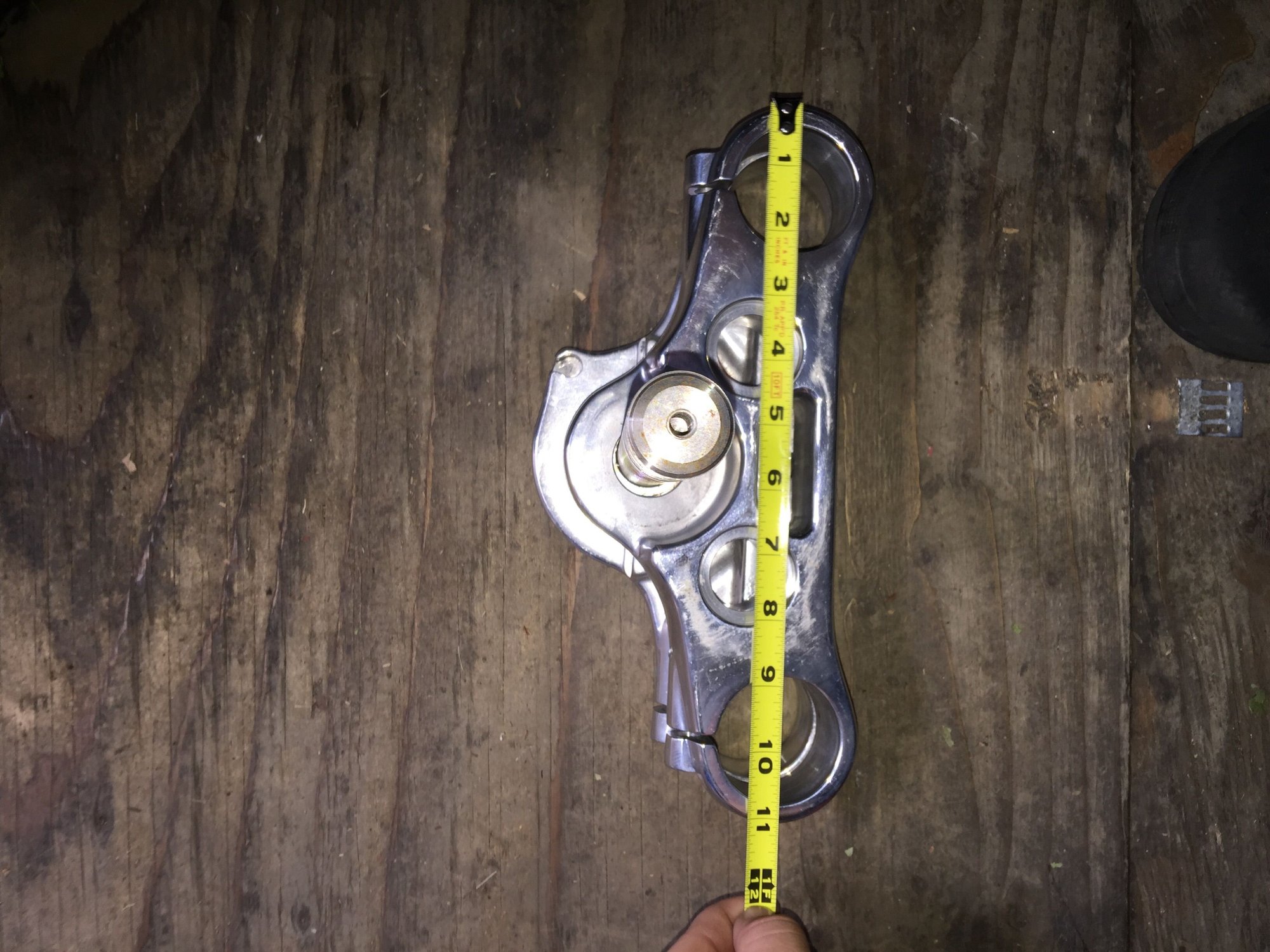

I've owned my streetbob for about 3 weeks now and I knew it had a wider than stock front tire (140/75R17). Today the PO dropped off the title, stock front fender (it's currently front fender less) and a set of triple trees. I didn't realize that this bike has non stock triple trees. The ones currently on the bike measure close to 12 inches (as pictured) and the ones he gave me that I'm assuming are stock are closer to 11 inches. I have a few questions about this whole setup as I don't know much about any of this:
1. What is the stock front tire size?
2. Does this mean I do not have the stock front rim?
3. Will my current rim accept a stock size front tire?
4. What triple trees are currently on this bike? Wide glide? Fat Bob?
I would like to get back to stock front tire size. How hard would this be for me to do? Is it more than just getting a new correctly sized tire and swapping out triple trees?
Thanks to all in advanced!

Looks to me like your mid-glide Bob has been converted over to a wide-glide front end, and a 17" non-OEM wheel/tire added on (19" front is std on the '06 Bob).
Might be worth your while to contact the PO for the answers you need, and find out what other 'changes' have been made to the bike.

Unfortunately it was the guy before the PO that made the changes so I cannot contact him. So will these triple trees bolt right up to the current forks and then it's a mid glide again?

You need to measure from the center of one hole to the center of the other...If you do a search on here, there is a measurement for a wide glide tree width.

Okay based on my measurements I have a set of wide glide trees. Can I just switch the trees out and use the same forks that are currently on it? Would like to go back to a mid glide with stock front tire ideally

Yes you can. I went from stock to fat bob trees on my 07 street bob and used the stock 49mm forks, and a 16" softail deluxe front wheel. Similar to what the previous owner of your bike did.
So as long as you have 49mm forks you can use the mid glide trees and a stock axle, spacers, stock wheel and you'll be good to go. Kind of expensive. If you just want a stock 19" wheel you can probably get spacers to fit in the wide glide front and adapt a fender to the wide trees.
Stock tire size is 100/90/19
You do not have the stock front rim.
third question answer is no.
current trees on your bike look to be fat bob

As long as you have 49mm tubes you should be good to go. The stock rim is a 19" rim and the stock front tire is a 90mm x 19", but I don't remember what the side wall height is. All those parts you have usually have a part number on them so check out if the are stock parts and what else you might need.
