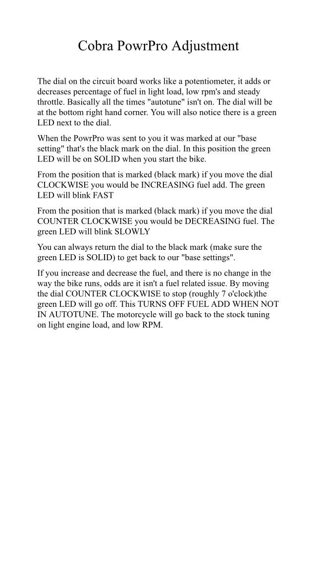

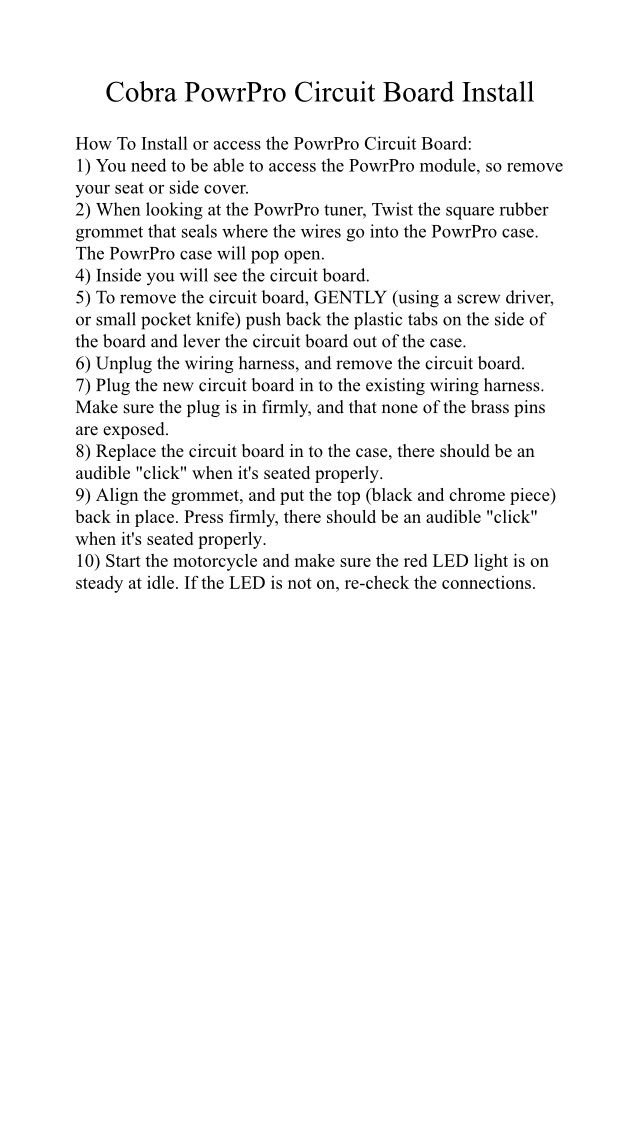

Default Cobra fi2000 powerpro issues and fix
I have a fi2000 powerpro and was having issues with it not working. Combe to find out, it is adjustable!!!
