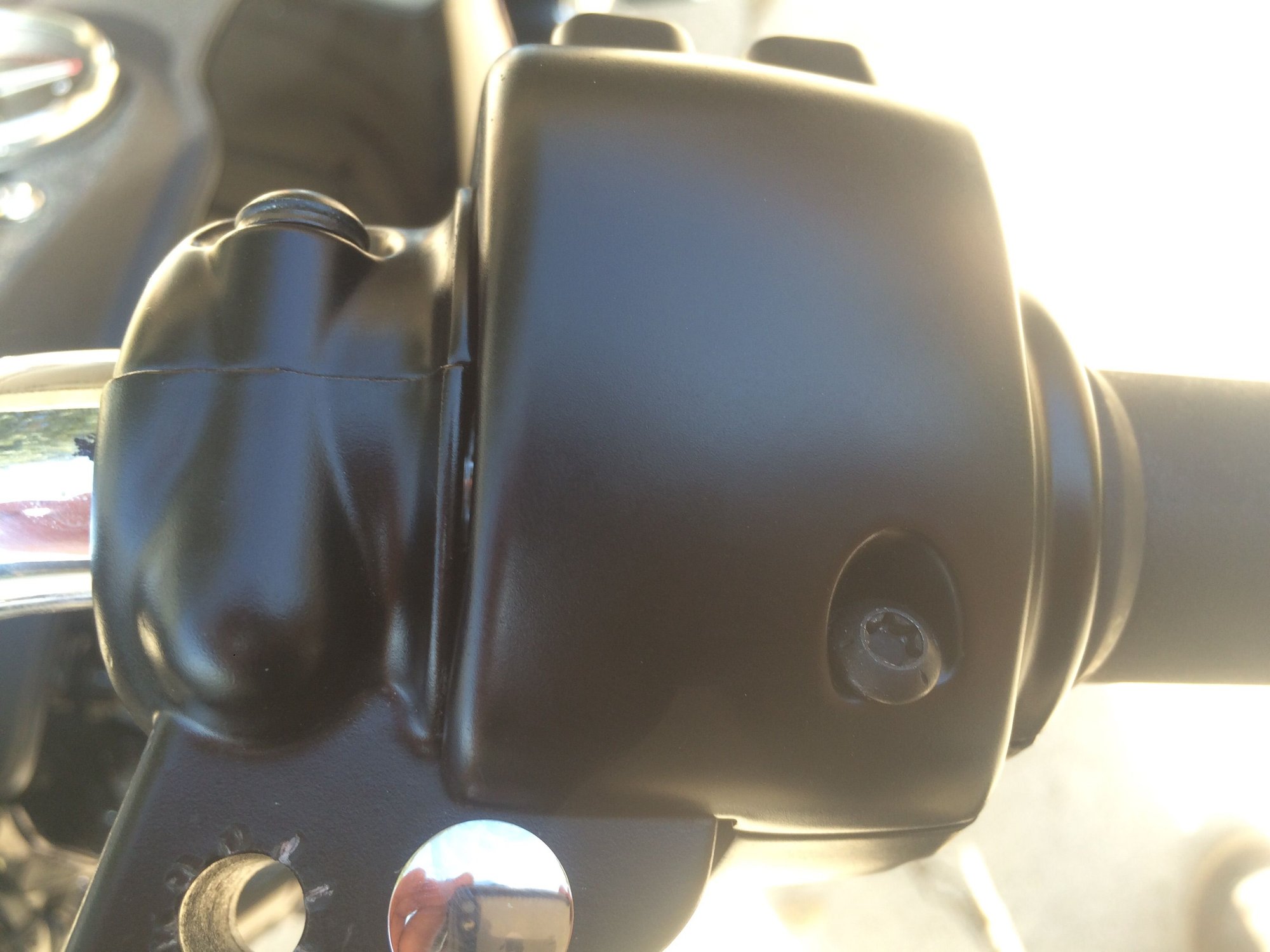

I have tried several times, several different ways and can not get the clutch perch to not have a small gap at the switch housing. Anybody else have this problem? It lines up fine till i tighten the clamp then i has a small gap. The master cylinder does too but not a bad.

Hard to see on mine since the turn signal is there but you probably got pieces from either end of the tolerance allowance.

It's a little hard to see but it looks like you are not tightening the screws equally. Thread them in loosely and wiggle the perch pieces to better align them and then alternately tighten the screws in an equal fashion. If one screw is too tight it will not allow the two pieces to clamp together properly. Be careful, those perch pieces are cast and will strip out or break if too much pressure is applied to those screws.

I had that happen with a new set of Kuryakyn chrome lever controls...I just could not get the clamps to align better so I swapped sides (same part for both sides) and the alignment was much better...also, your photo looks like you might be locating the clutch lever assembly on the handlebar curve which will create a gap between the switch housing and lever control along with the alignment problem you are experiencing.
Just keep messing with it, it will line up better...

What i do is close the gap on the top screw the torque them equally. Is that not right is there susposse to be a equal gap top and bottom?

Although it does look like it in the pic it is not on the bend.

...there probably should not be that much of a noticeable gap if you have the correct diameter controls for your handlebars..

Gotcha ill retry it one more time. I wonder if it has to do with my original bars were polished and my ones are chrome.

Like the chrome plating is just enough to throw it off
