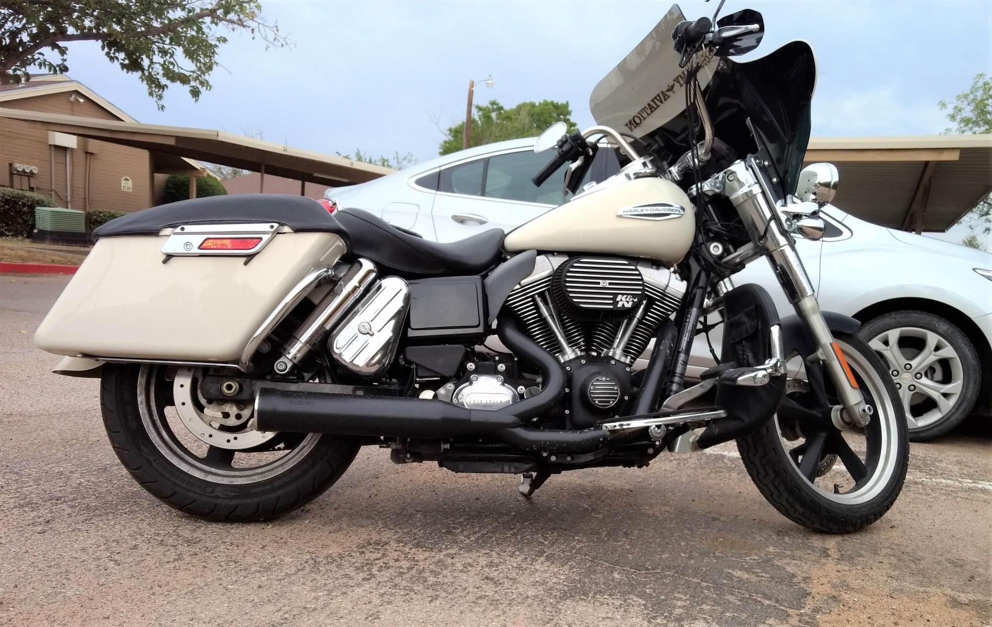

Newer image, hope it helps.
I have the Softail Slim on my Switchback also. It bolts right in, no shimming and no bending. Direct fit.
