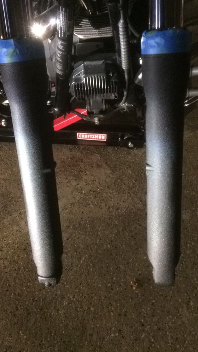

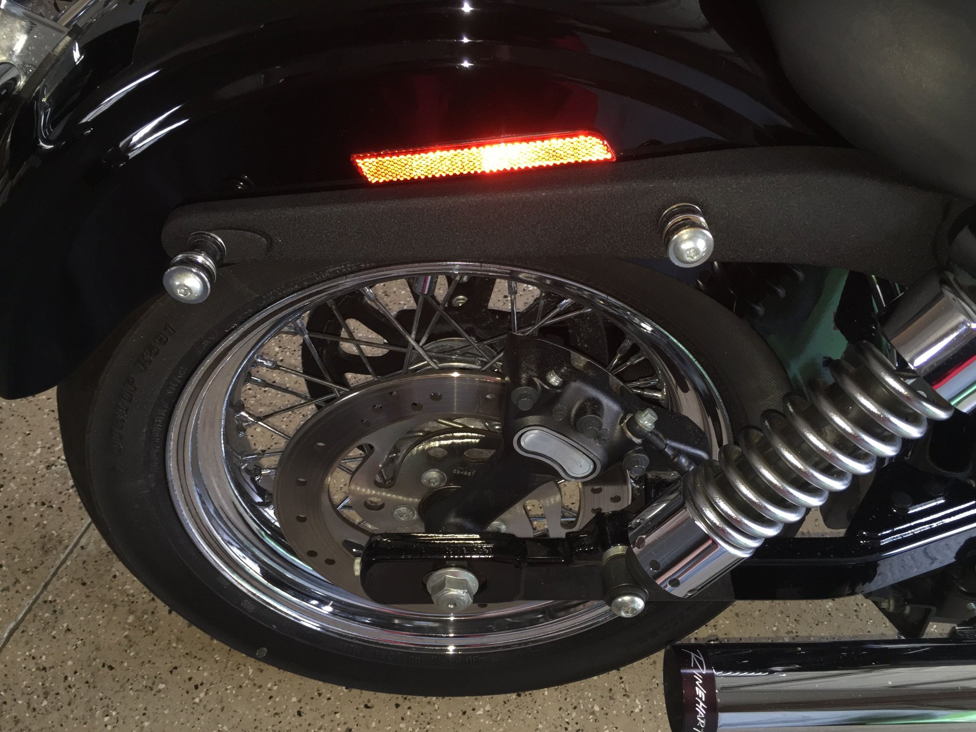

I'm with you on doing it yourself. VHT wrinkle paint is very easy to use. It matches the factory wrinkle paint pretty well.
I painted most of my chrome parts with it. Some parts I took off the bike some parts I left on and just taped around and covered the bike. I did the fork lowers, rear strut covers, AC cover and derby cover. You can scuff the parts down with 220 grit paper and finish them with 600, wipe down with a prep paint cleaner. Just make sure your at room temp when painting. Only used 2 cans so far. Total cost 15$.

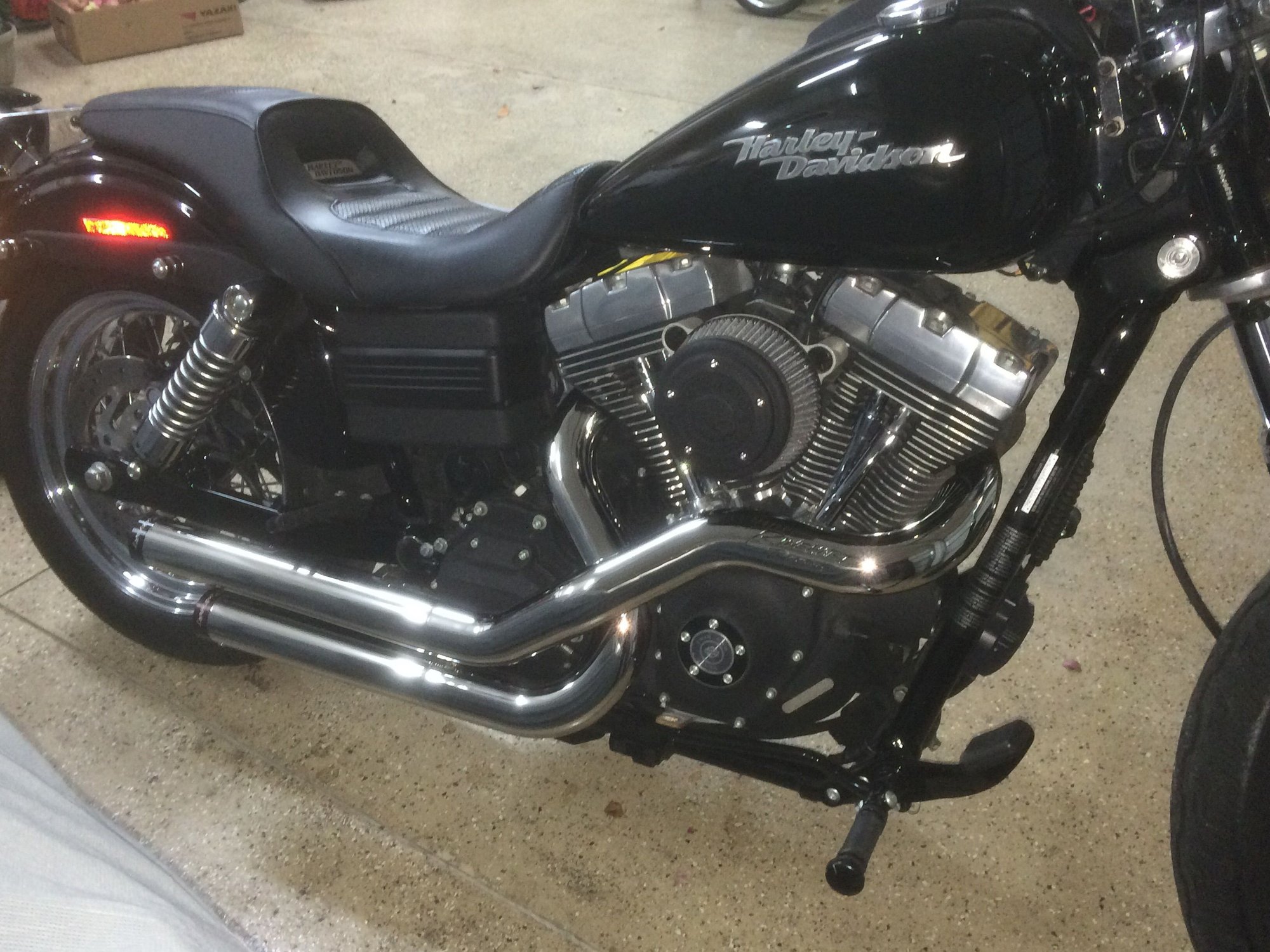

That looks great. I have been wondering how the wrinkle paint would look on the forks. Any chance you could post a pic of your whole bike from the side?

Dang, that wrinkle looks sharp. I've used the VHT on some other parts too. It seems to hold up well to the elements.
Harley sells their wrinkle paint in spray cans as well.

This is the only one I have right now.

Thanks! Yea it does hold up really good. I was going to get the harley stuff but autozone was closer to me.
