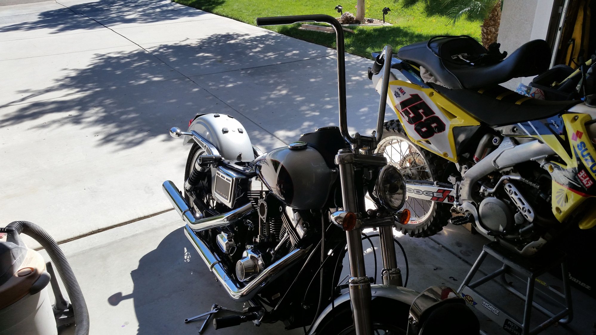

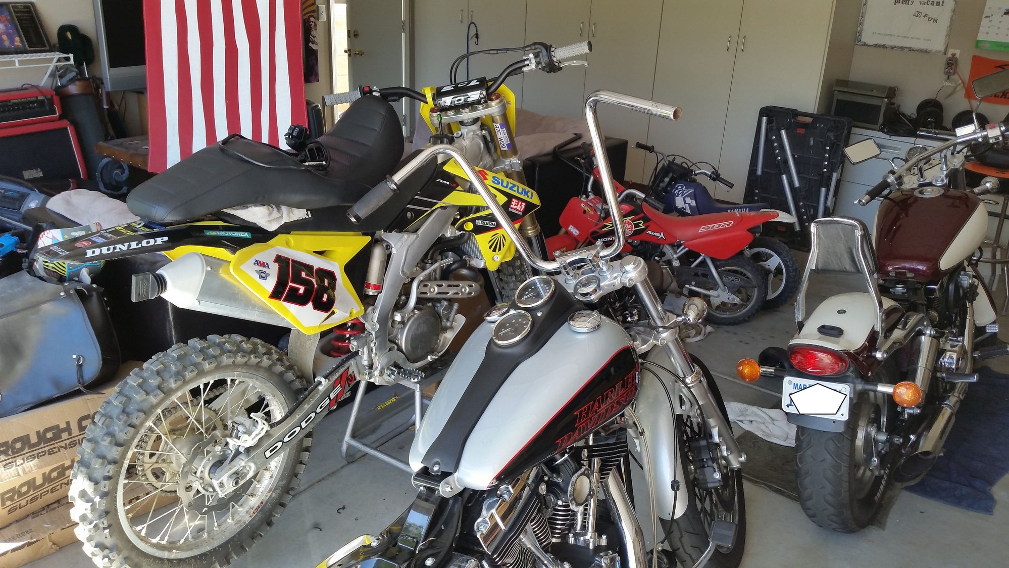

Get rid of that riser set up, I hate it, I just installed my apes this weekend. I was told they are 14" but they sit above my shoulders, not by too much, still comfortable. I bought stock super glide cables, I was told they are the same as street bob cables, come to find out none of them will fit. Luckily the swapmeet was this weekend in long beach, I got a set of apes, 3.5 inch riser, longer steel braided clutch cable and longer steel braided throttle cables for 40 dollars.
You can get a healight relocation kit from Dk customs for like 30 dollar, thats what I did. Or you can get a stcok streetbob headlight with mount. The internal wiring is easy, the stock wires will reach. I also used a stock street bob riser....here are some pics, though I took these in the middle of working on it so not complete...
Here is a break down of what you will need...
-Bars
-Headlight or relo kit
-risers
-longer clutch cable
-longer throttle cables
-Longer brake line (Dual disc ABS or non depends on what you have)
-Transmission cover gasket
-lots of beer.

oh BTW, when you are pulling the wiring out of the frame, be mindful that the start stop switch side wiring actually has 2 plugs. One is alot smaller than the other, I ended up tuggin on it and pulling the wire out of the connector....Pain in the *****.
