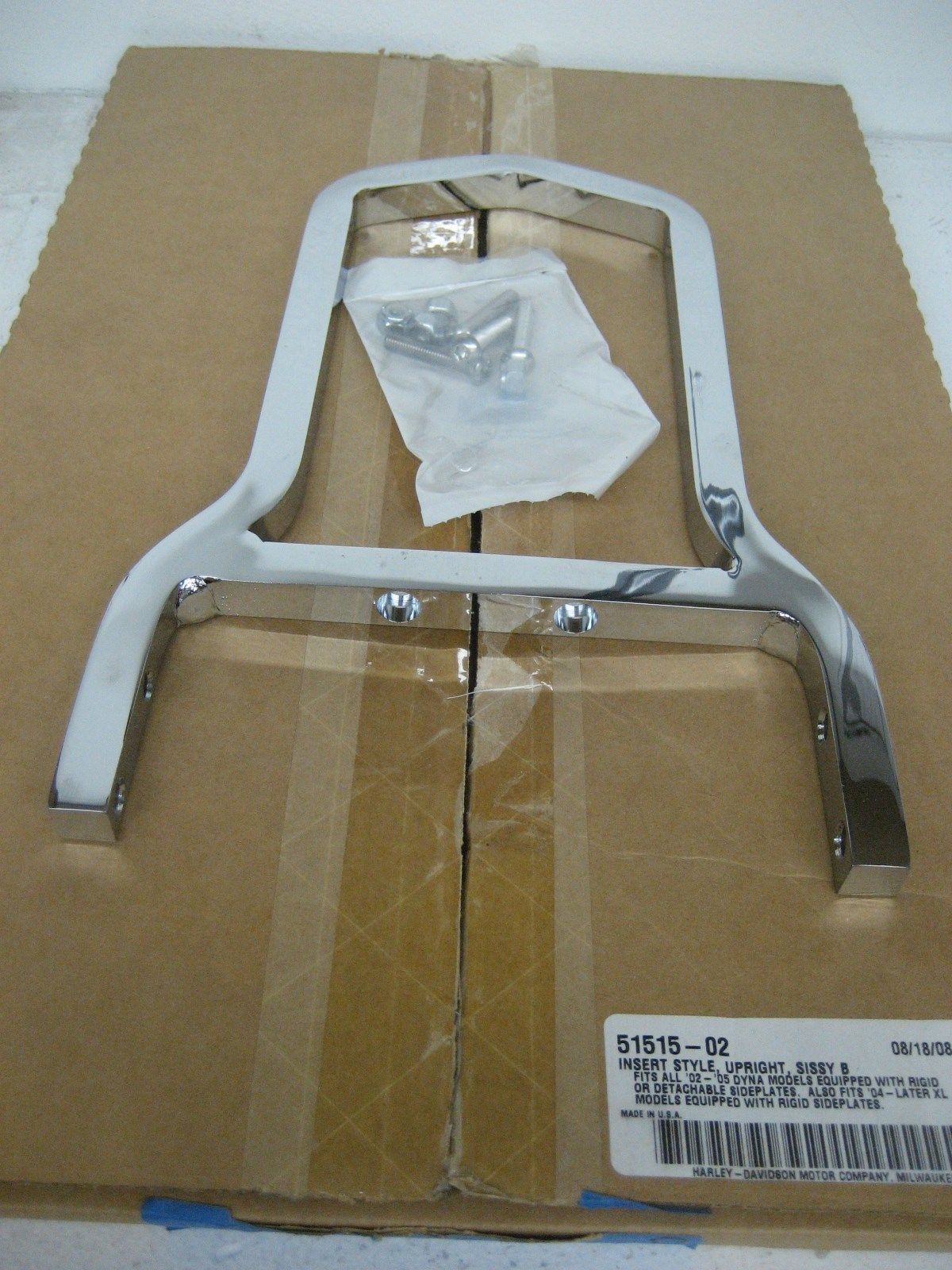

Here's an image from Ebay showing an upright with button head bolts and nuts

The bolts you need are 1/4x20- 5/8" long. The HD part # is 94592-98 and you'll need 4 of them.
