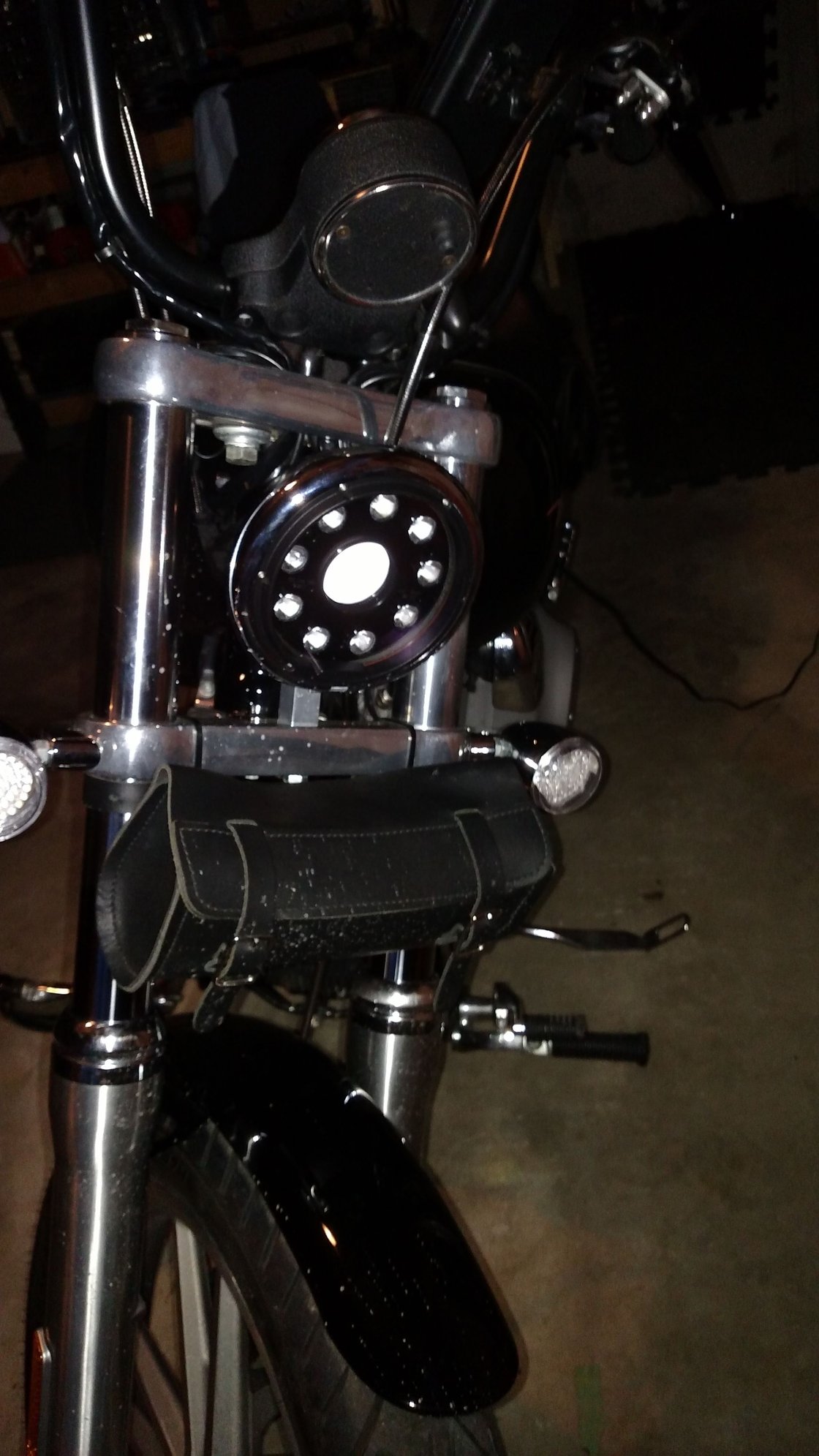

Just installed mine last night! Super bright! I believe the high and low beam is wired backwards, but I don't plan on running it on low beam anyways. I had to remove the silver ring inside the bucket to get it to sit inside. I was able to get the trim ring tightened with the stock bolt once i removed the internal ring. 2015 fxdb

Ok question. Are all the outer lights supposed to be low beam. That's the way mine works then when I switch to high beam they stay on and the center lights turns on also.

I would say so..... On low beam all of the lights on mine are on... High beam the center light goes out... Figured it was wired backwards... I'll leave them all on anyway..
