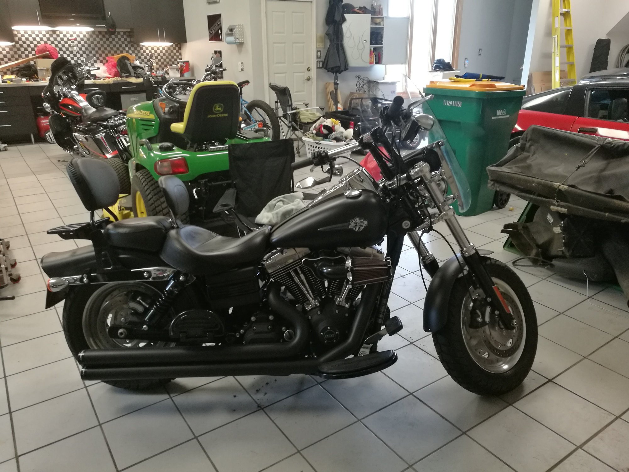

So I purchased the 3" fat risers from DKcustoms for my 2013 FXDF.
1. First of all, the quality of the risers is not great. The paint couldn't scrape off easier....almost as if they used plasti dip (not good).
2. The 3" length didn't cause as much cable issues as I expected.
2a. I had to take the clamps off of the clutch cable and will definitely need to re-route the clutch cable next week. When the front wheel is turned all the way to the right, the line is super tight.
2b. I removed the bolt on the underside of the bottom triple tree to get some more length out of the brake line. It doesn't look as nice as it did when it was bolted down, but it isn't alarmingly tight if you didn't mind that the cable isn't as hidden. I'm debating if it's worth getting a longer brake line kit because I'd like to get that cable hidden again.
3. Comfort wise, the 3" rise is amazing! I am 6'0'' tall and it is perfect for me. An inch lower would have been too short. I also have a floorboard kit, so it forces my legs more forward making me want to lean back.
