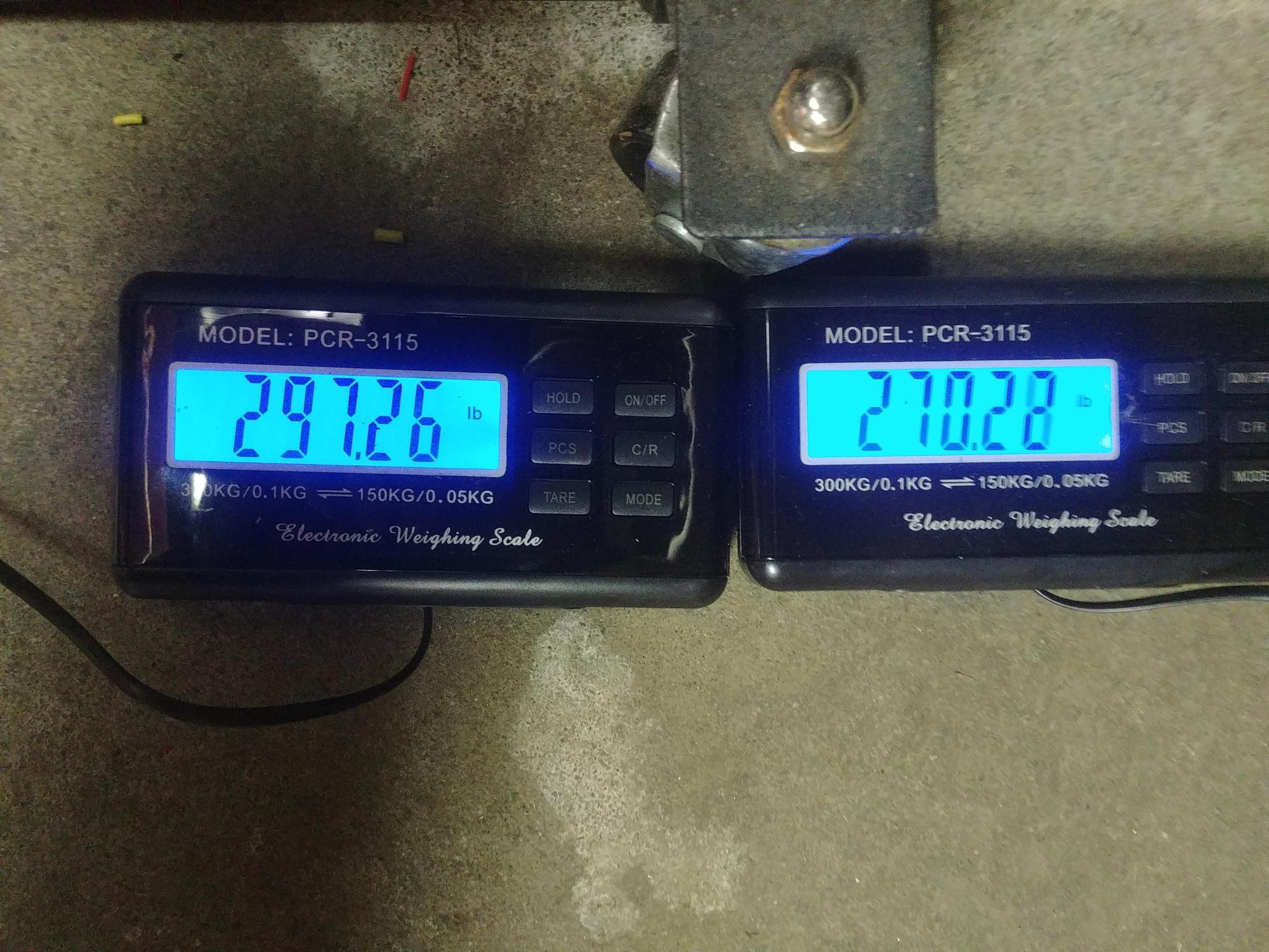

All buttoned up other than the fuel levél sender.
Started researching what needs done to get it registered since it's a salvage vehicle. During the inspection, it looks like I need to produce receipts for every replacement part over $100 so I've been digging thru my records. I wish I had known that 2 years ago. I didn't keep many of them. It's against my personal ideology with regard to hobby expenses. I don't want to know...
It's illegal to operate a vehicle on the road with a salvage title, except to go to the inspection. (Once the bike passes, it gets a "rebuilt" title and is legal to ride.) Looks like the nearest inspection station is about an hour away. I'm not comfortable doing 2 hours without a couple good shakedown runs, so I guess I'll risk the $2000 fine. Fortunately I live out of town so I can ride country roads amd stay away from the police.
Ohio law requires mufflers with "baffle plates" and a max decibel level of 86 (82 at idle). That's crazy quiet.* I may have to fit a stock exhaust to pass inspection. I have head pipes but I think my mufflers are gone. Will have to dig around.
Gonna call the DMV Monday to see what they have to say.
Anyway, she gained 10 pounds in one afternoon.
Rear/Front
