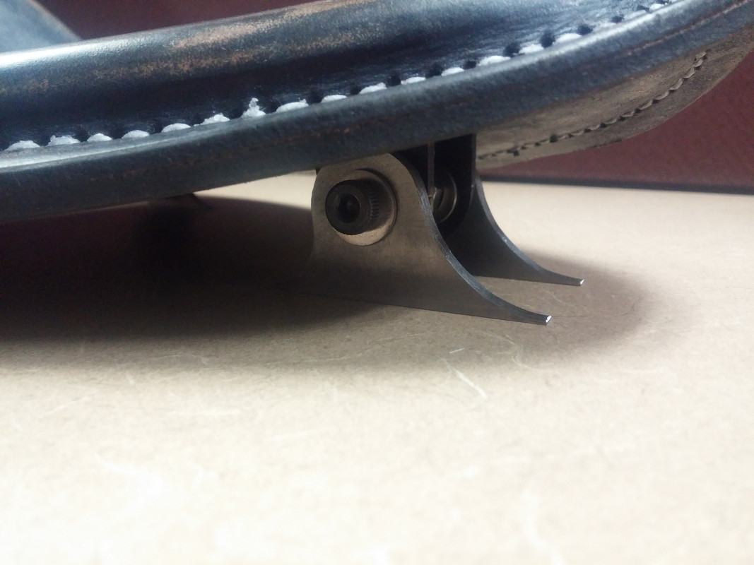

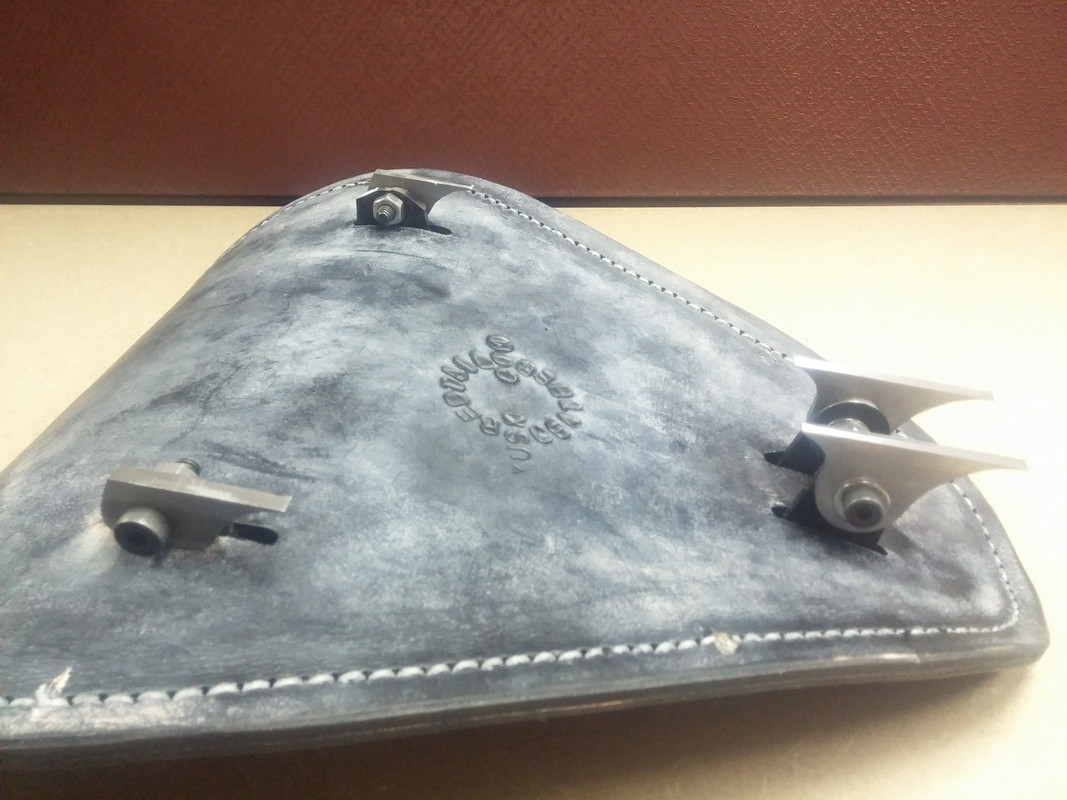

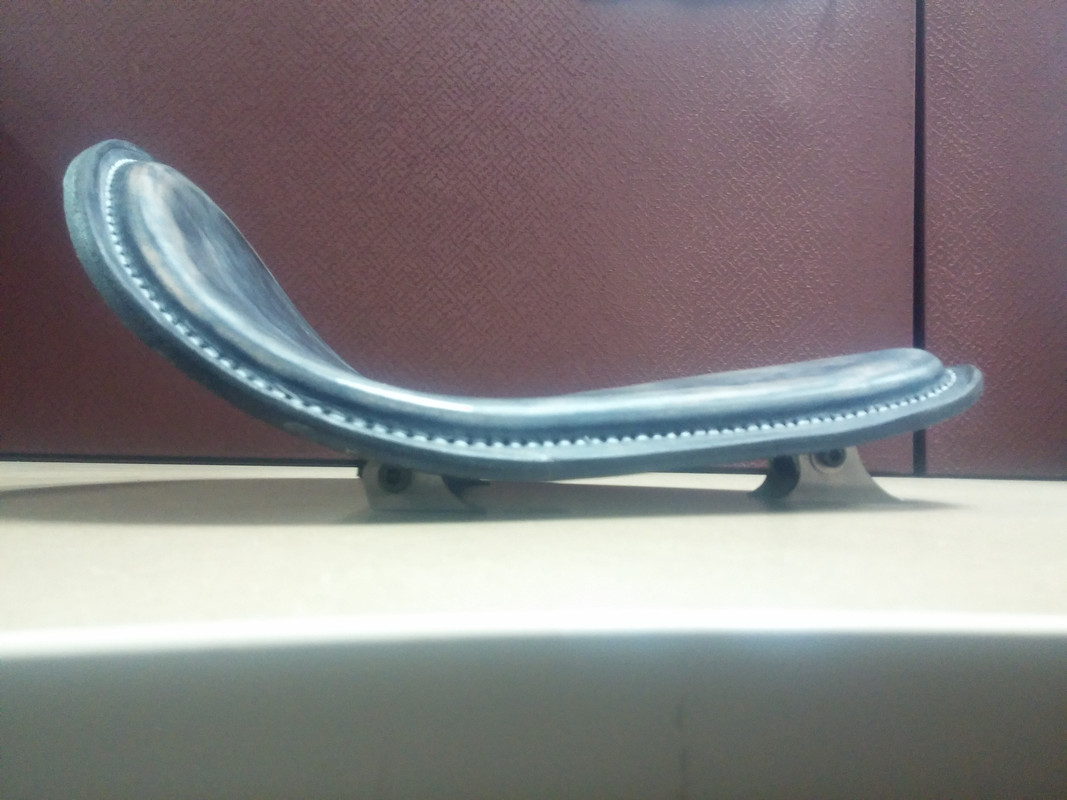

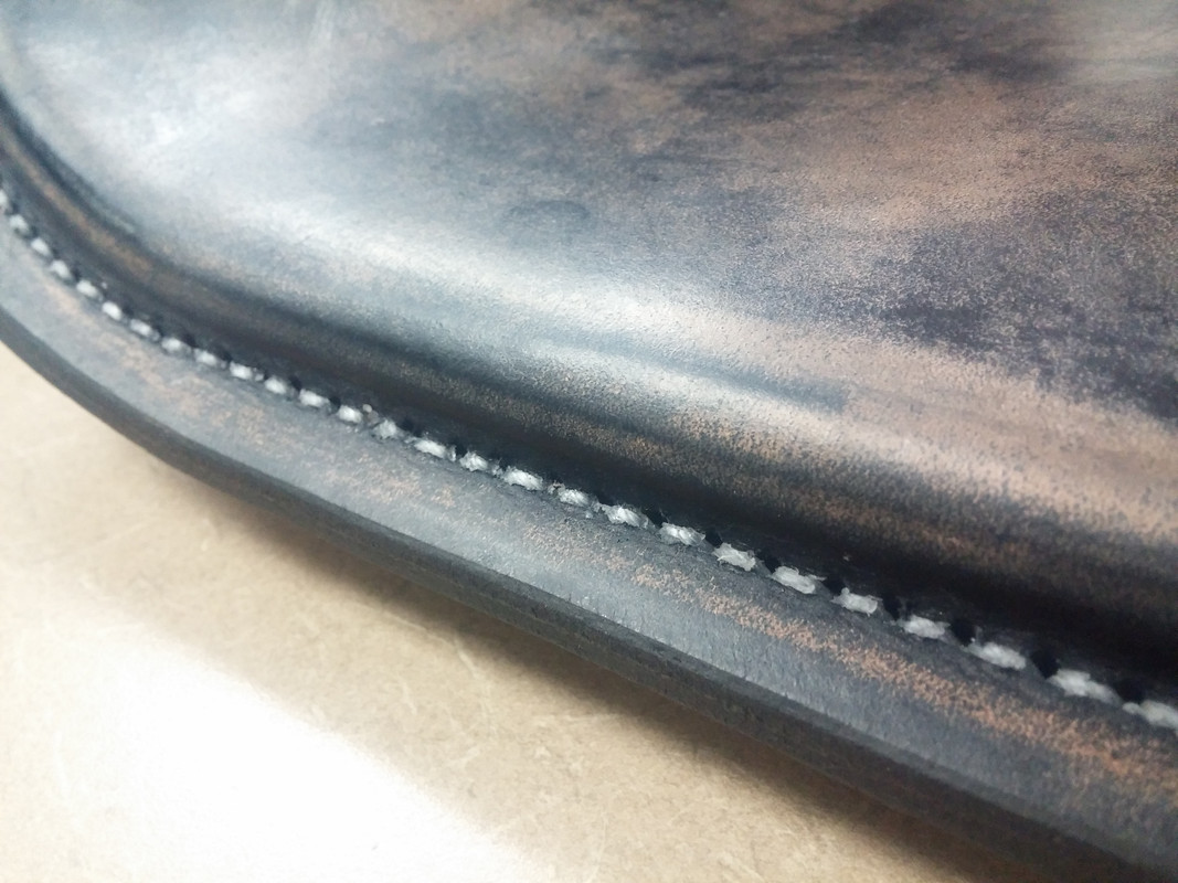

Laying out the seat mounting tabs and grabbed a couple better pics of the seat. I'm going to add some black stain here and there to refine the wear pattern a bit. Too random at the moment. Many thanks to Chris at Retail Leather for the fine seat.

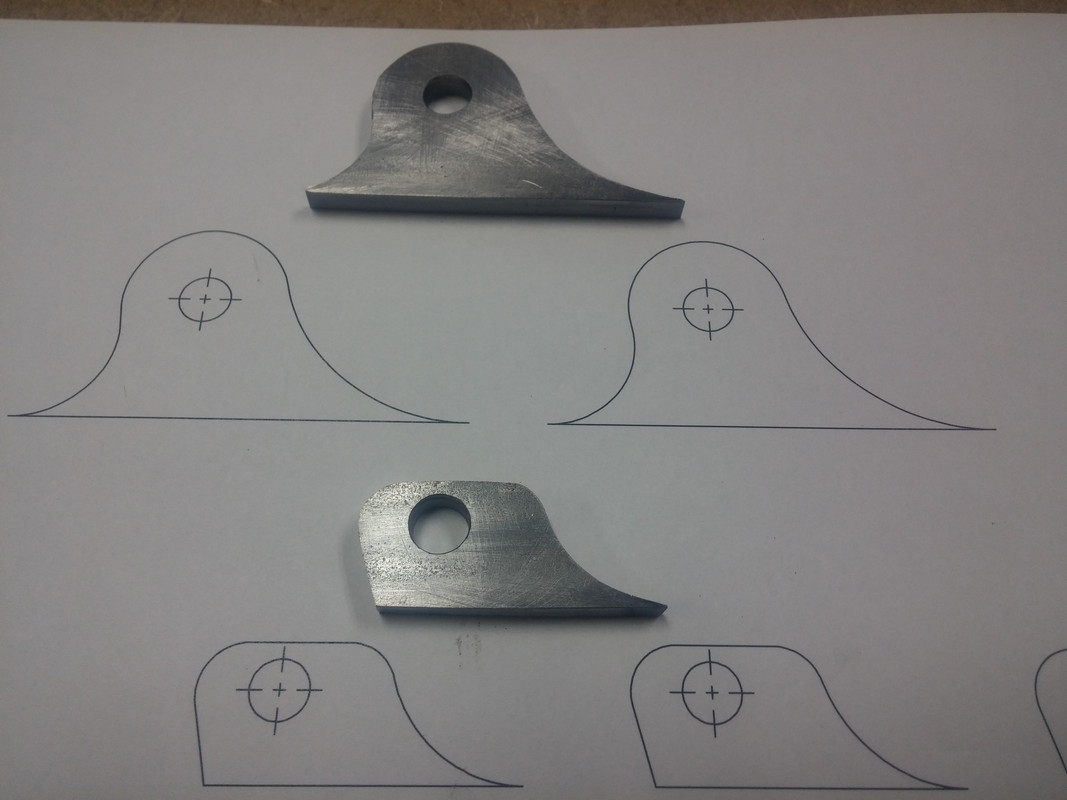

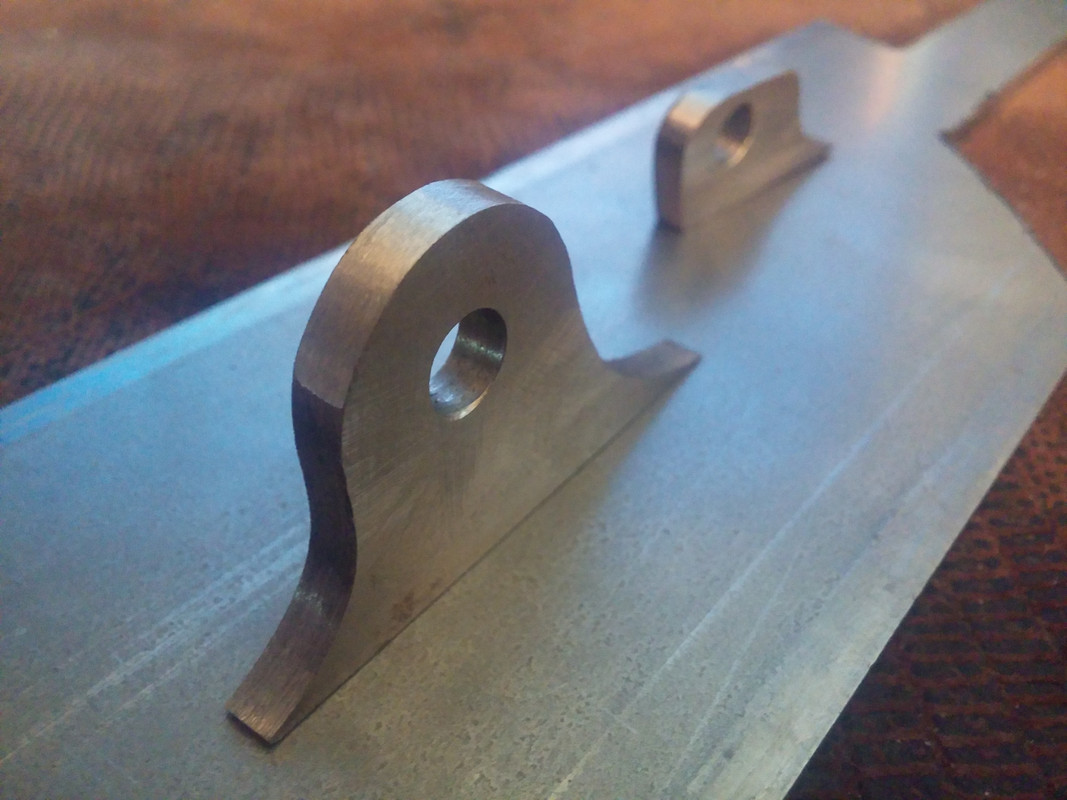

Seat tabs are ready to weld. The front might need a bit more height. I'll test sit it before I weld them to the frame.
3/16 cold rolled. Cut on a band saw and profiled with a die grinder. 5/16 x 3/8 shoulder bolts. Temporary. I still need to order the button head stainless ones.
