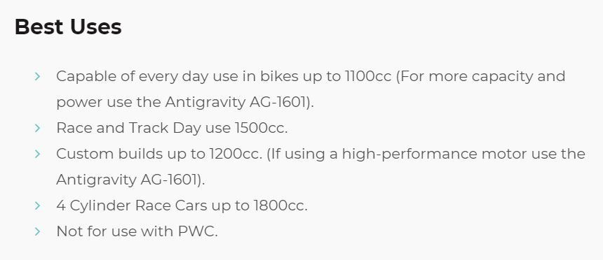

Question on your battery: I know it hasn't been long yet, but does it spin the starter with authority? It seems to be battery time for me... still working, but seems slower than a few months ago (and I've never changed it)... I have more compression than you do, but always use the manual release valves. Reading the Antigravity recommendations, I'm a little worried about the 1201, although I love the size... For this reason I'm leaning towards the 1601, but I'm curious how the 12-Cell is working for you...

I had the same concerns for the same reasons. It cranks like a champ, man. Seriously. No idea what all the factors are but in addition to the battery, I also upgraded the starter to an All-***** 1.2kW and the wiring is pretty damn good. 4 gauge tinned OFC with conductive grease and solid copper lugs.
I have started it accidentally several times. The starter button plays triple duty as ignition/start/kill. Double click for kill and ignition. Press and hold for start. If I don't double click fast enough it sometime tries to crank...and it has started a couple times...
I was also concerned about the reserve capacity but I still haven't plugged in the charger and I have done a LOT of quick heat cycles and assorted electrical testing with no hint of trouble.
Combine that with the "safe" failure from my dead short and I'm completely sold. Time will tell, but I can't see ever going back to lead acid. If I didn't want the extra ballast at the right rear of my car, I'd switch to lithium iron on it too.
