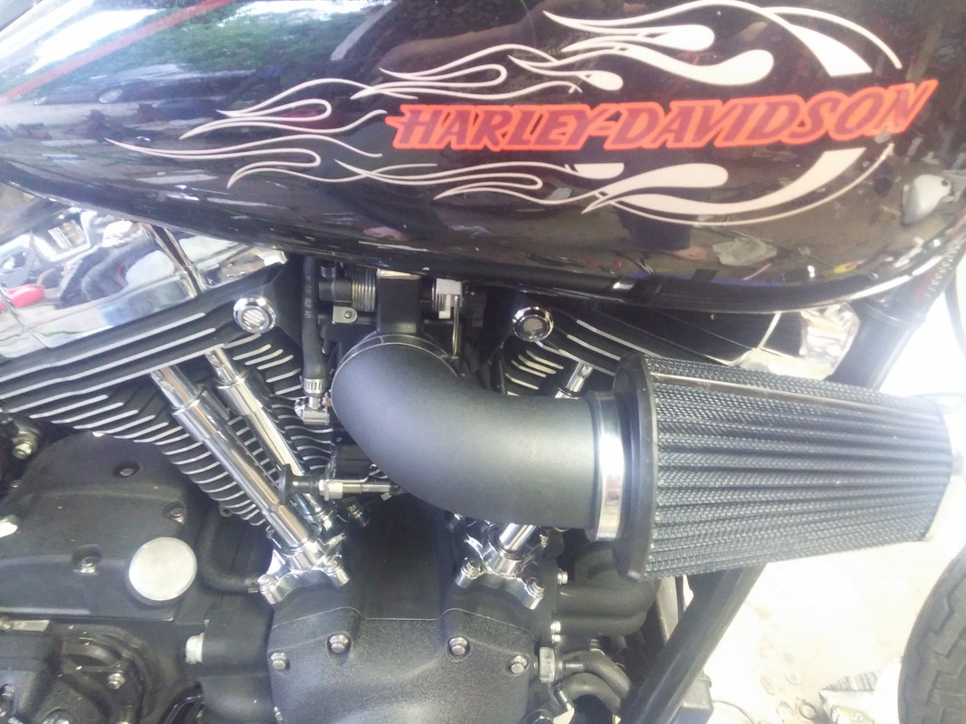

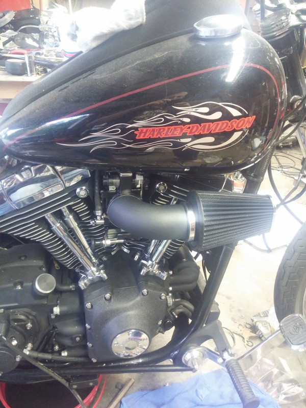

The paint on the induction tube is dry enough to install, so here it is...
I know this style AC is non traditional and certainly isn't for everyone, but for me it's form following function. I tried a couple other ACs and they all interfere badly with my knee. This one doesn't.
None of that bulky bracket and breather crap here!

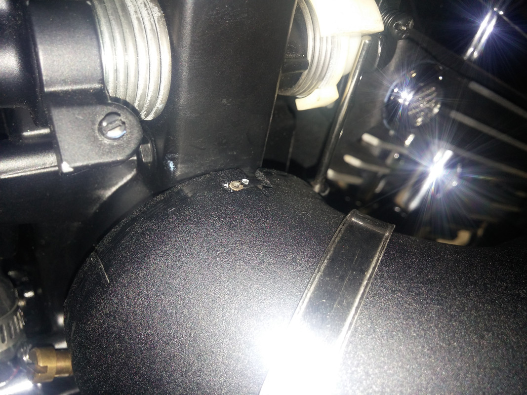

I built the tube. The filter is a modified (dyed black) K&N. The tube has cam lock slots in it and I pressed pins into the carb that lock it together. The band clamp is extra security.

Kinda hard to see but here is the top lock and pin.
