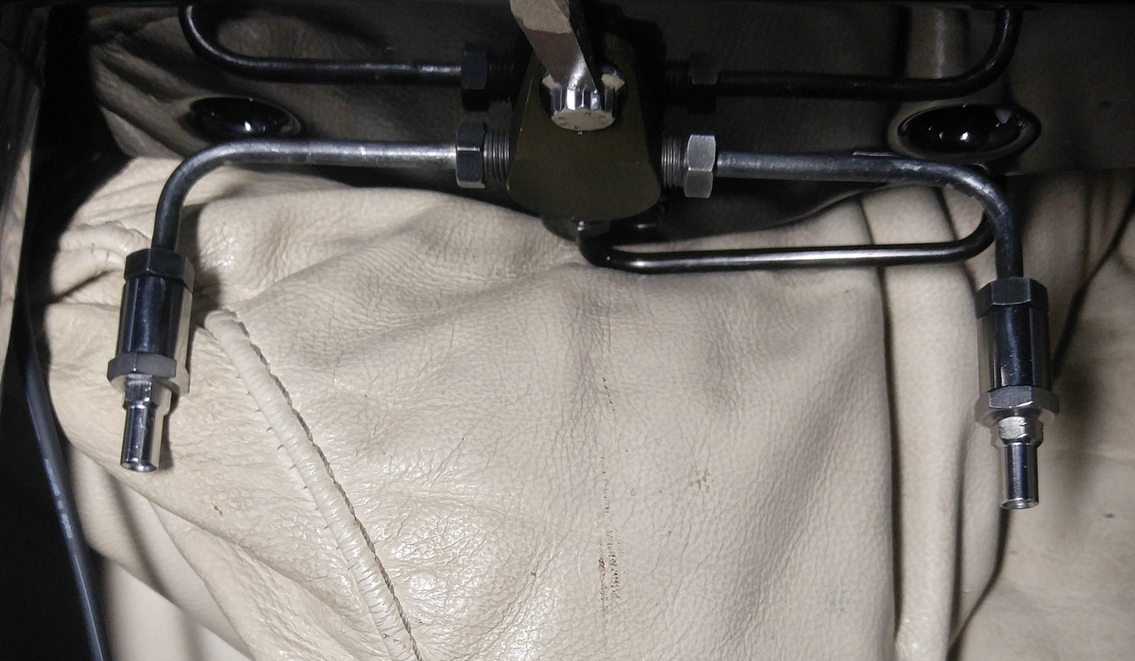

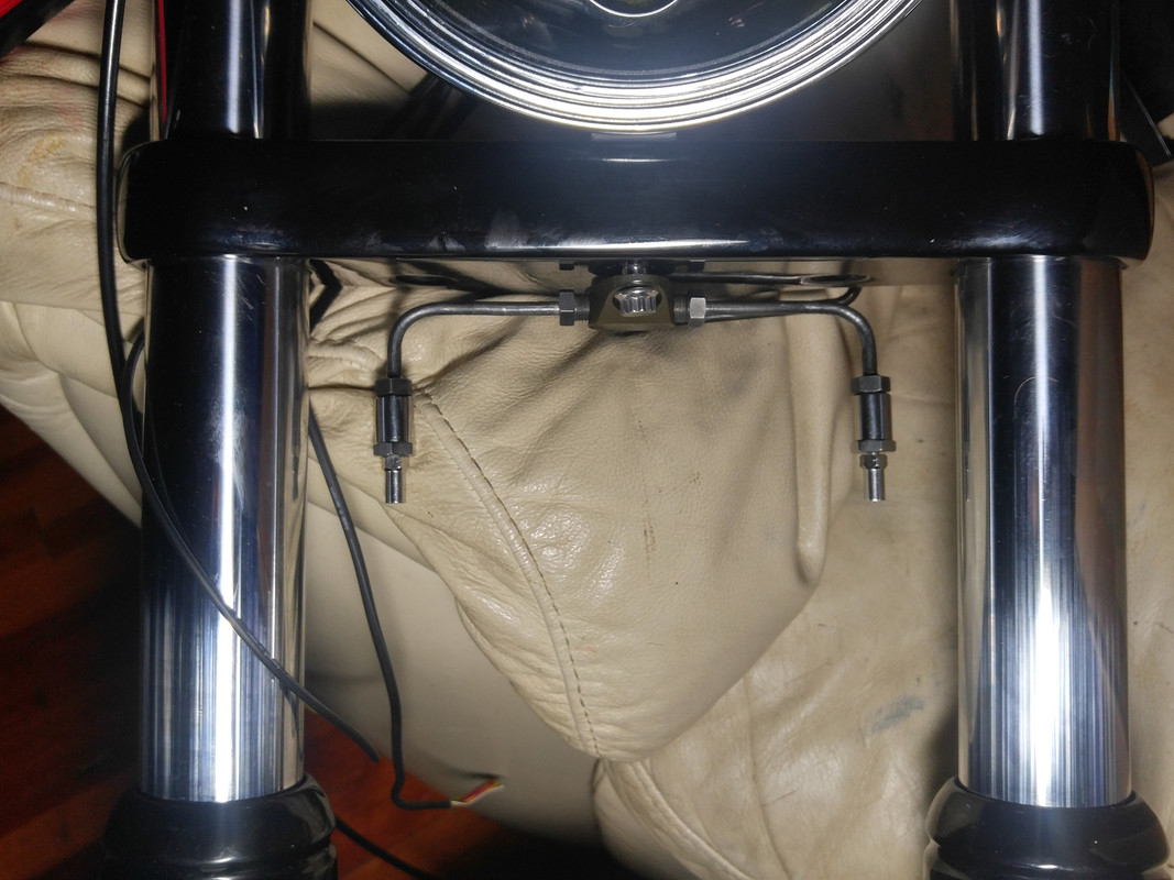

Started playing with the front brake tee, too. Nobody seems to publish the dimensions for their bent tube lines and I can't find straights with 37 male flares, so I guessed. It sucked, so I rebent them. Still sucks. :/
I ordered a couple more tonight that look longer. They'll need re-bent, too, but that's OK.
