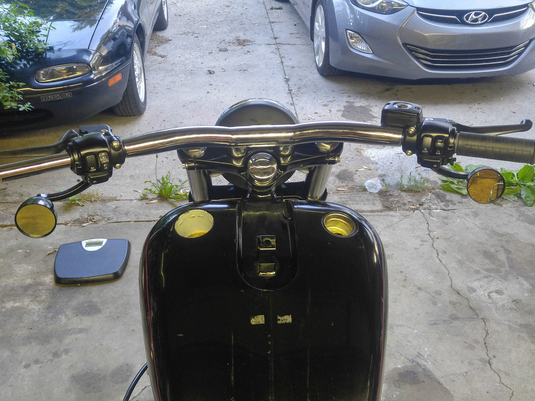

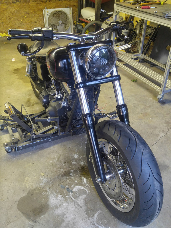

First fitup of the complete front end.
The bars and mirrors clear the tank easily but the pinch bolts hit. This seems probable with all big tank conversions of this type. Otherwise the conversion is drop-in. Didn't even even need to modify or remove the steering lock. It no longer functions, but it doesn't impede either.
With regard to the pinch bolt interference... Not sure if I'll move the tank back half an inch (which does clear) or modify the steering stops. I wanted to do a tank lift, too. Need to do some mockup and see what works.
I'm not ready to put weight on it yet, but it seems very short in the front already. Longer tubes seem a given at this point.
I didn't stop to get pics but before I installed the new races and bearings in the neck/stem I spent an hour or so cleaning everything, hitting all the rust with rust converter and Scotchbrite, then applying a thin coat of grease to prevent future corrosion. It cleaned up nicely. Wish I would have taken some pics. Oh well.

are the arp heads what hitting? i know you wouldn't dream of it but, would the issue be there if they recessed hex type? tank lift?
I checked that. The OE button heads hit too. No biggie for me, but I figured it was worth mentioning for others. A lift makes it even worse. It hits well above where the tank curve stops.

After talking to my crew, we think you should axe the tank, leave the forks alone and run inch shorter shocks.
