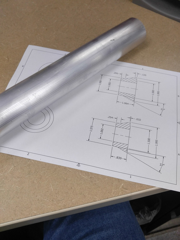

Picked up the 2" barstock for the front axle spacers. $22 for a little over 13". It was a drop they just laying around and it's WAAY more than I need, but I'll use it up eventually. Hopefully I can make some chips tonight.

Shifting the last Dims around, I see..
I KNEW you'd notice that! Yes, the rotors were just a hair off. The rotor-to-rotor dimension was right, so I just needed to shift the hub a bit. It will put the tire .030 off center unless I offset it, but that's not too bad. I didn't want to shim one rotor (and machine the opposite flange) or buy another hub.
