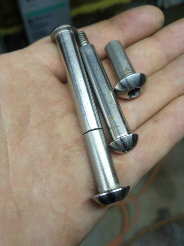

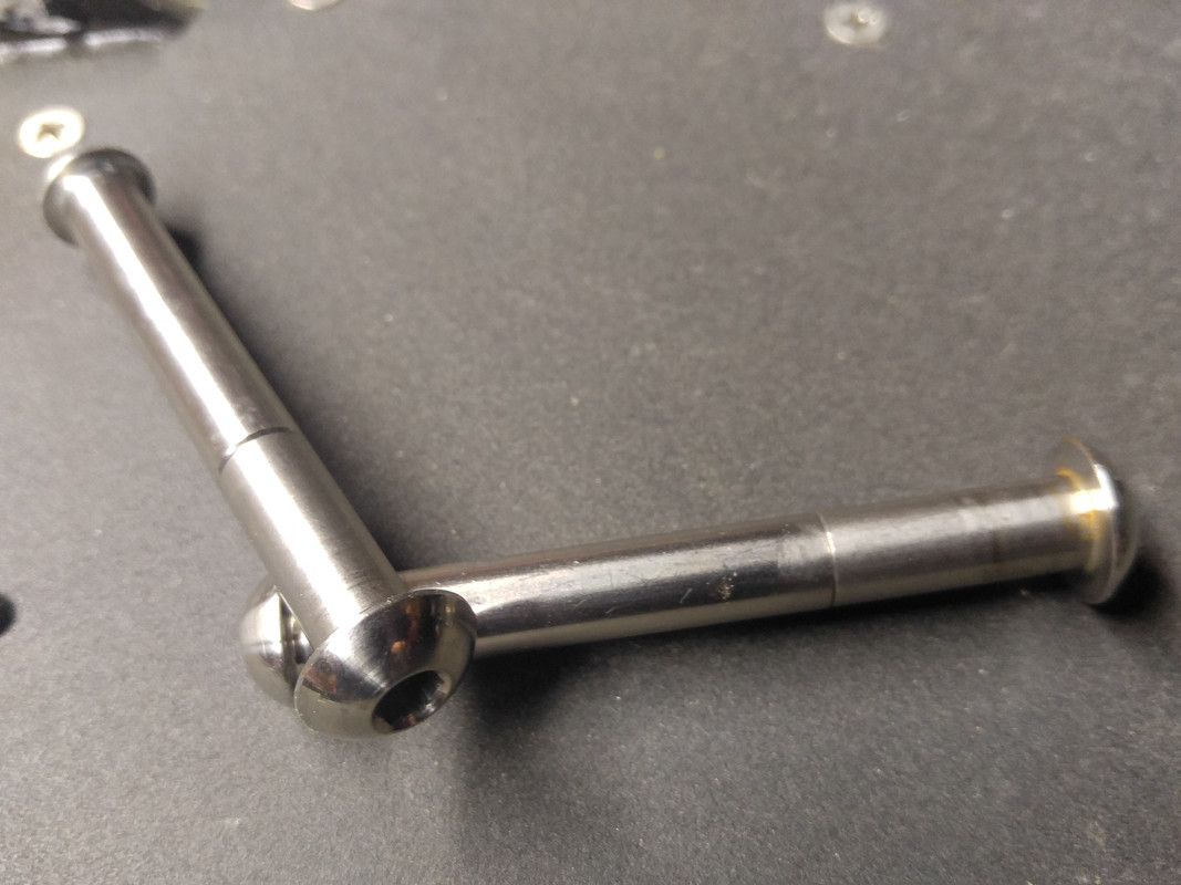

FedEx man just dropped off some more hardware.
Got some stainless 3/8 sex bolts and shoulder bolts that I plan to modify for tank mounting bolts.
Some stainless 10-32 undercut flat head screws for the seat trim mounting.
Grade 5 armor-coat socket heads for sprocket adapter.
Grade 5 hex caps for sprocket that will need modified to fit.
Stainless button heads for brake rotor.
Custom tank bolts...

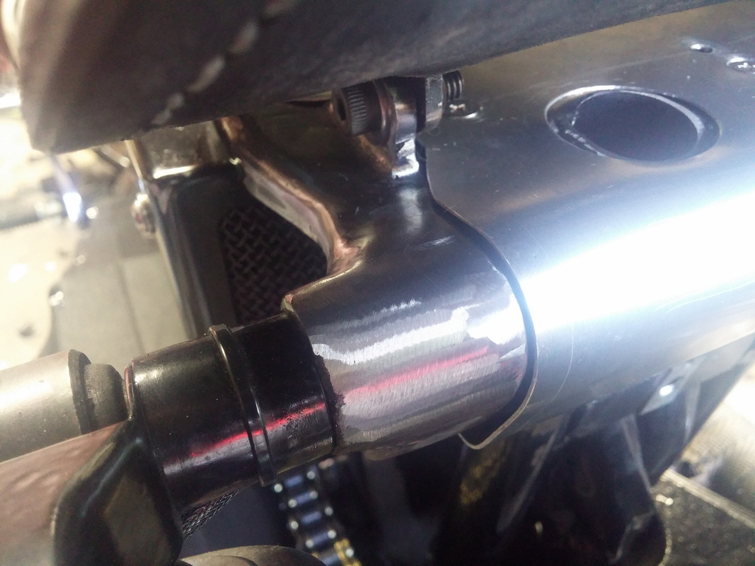

Fitted my tail light brackets and the sleeves that cover the top shock bolt. Small detail but worth the effort, I think. Refining the shock mounting ears and cover fit, too.
