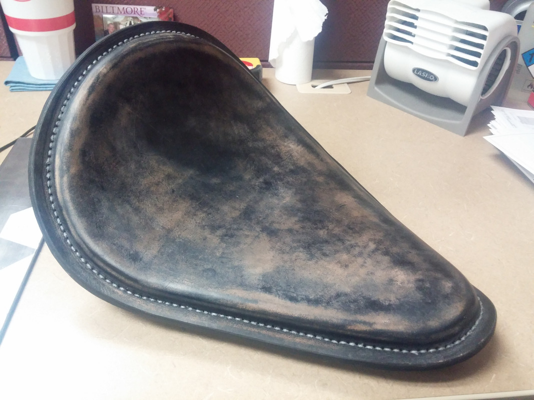

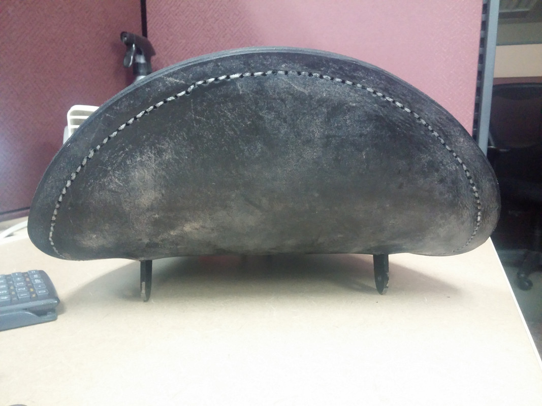

Got my seat from Chris at Redtail Leather today! I still need to finalize location and fab/weld the mounts, but I like it. This is the second seat I ordered from him. The first was way too small. I wasn't too sure, so the first one was just a bare pan.

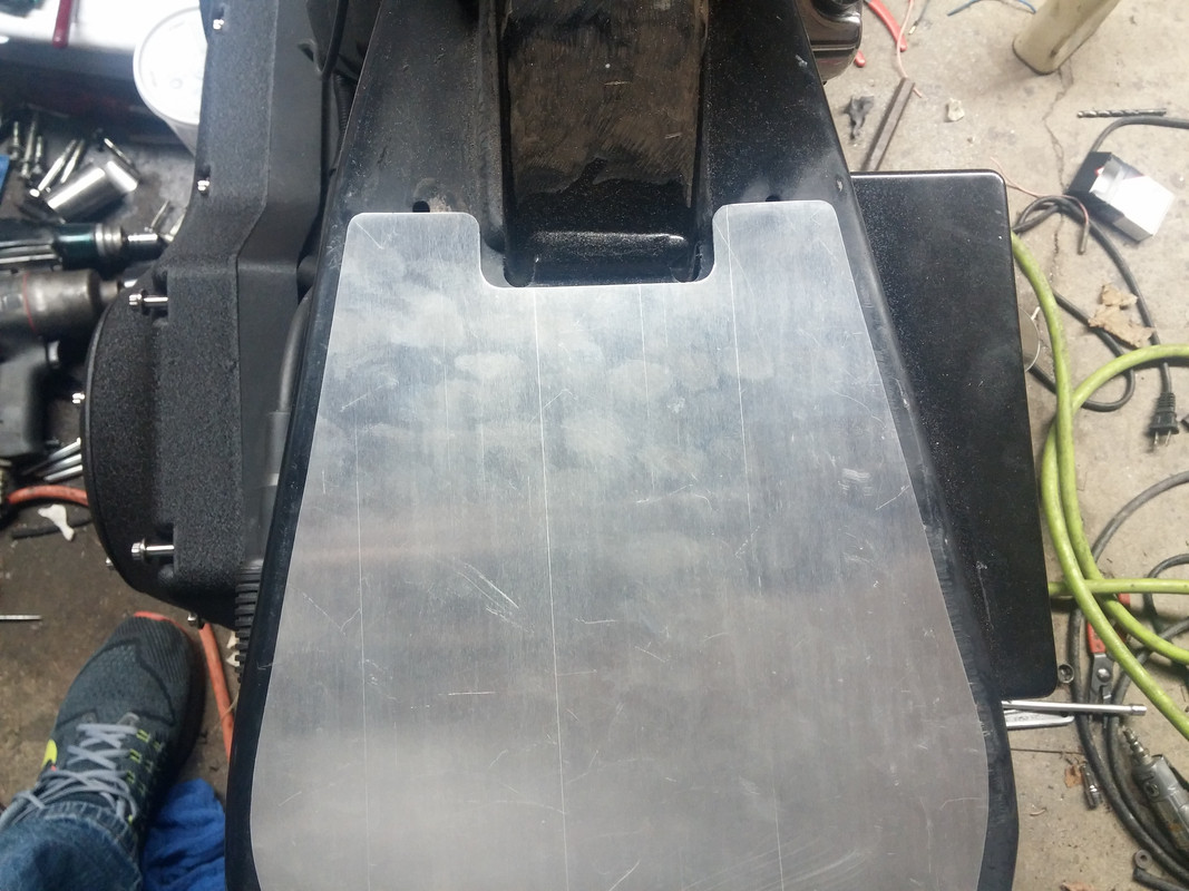

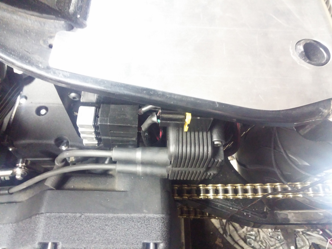

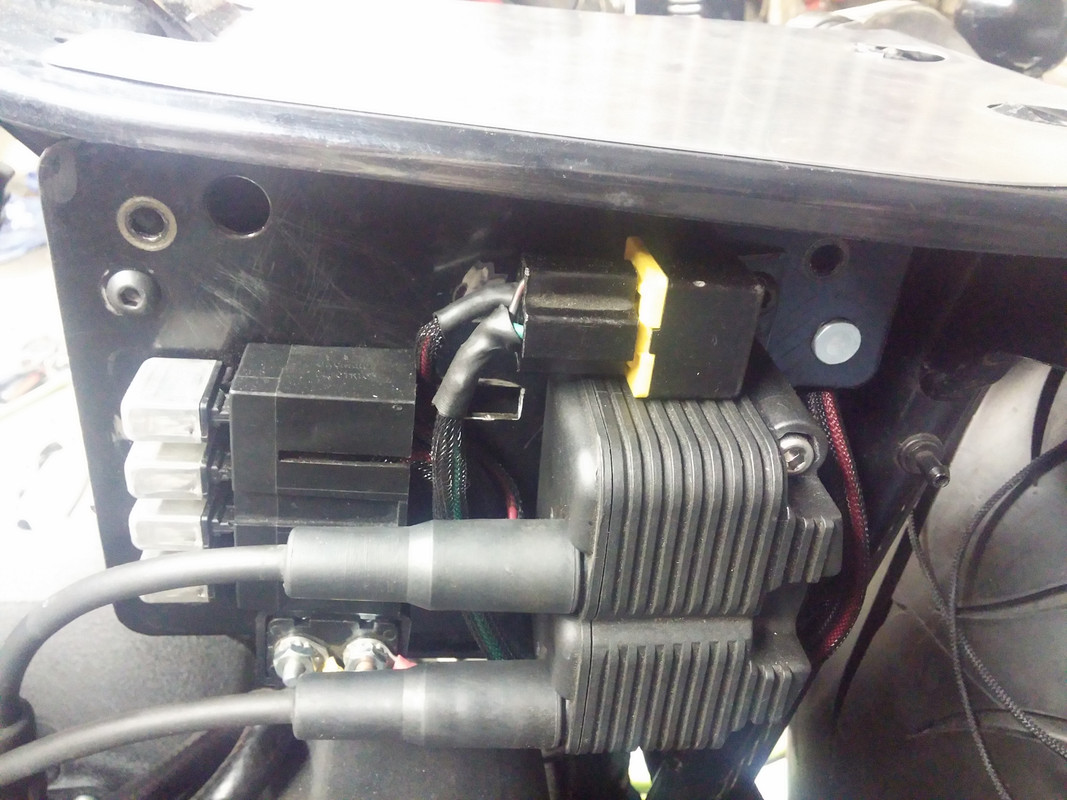

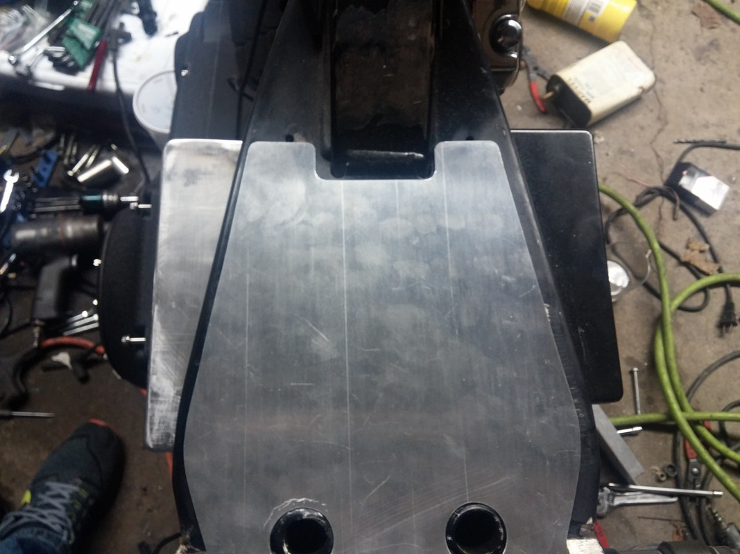

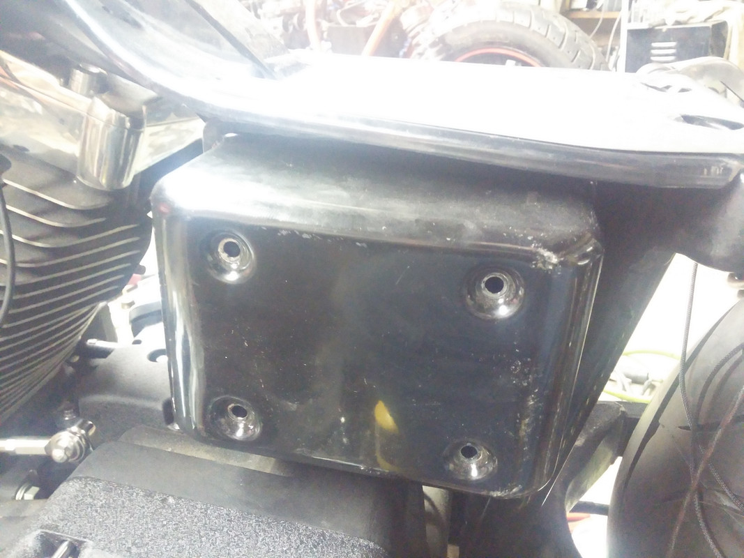

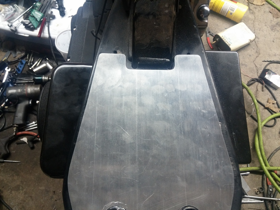

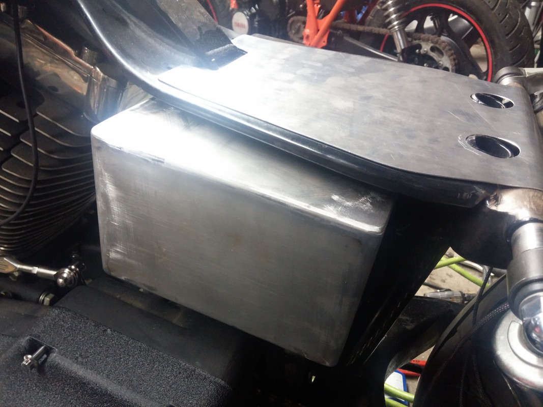

Got the electrical box more-or-less done tonight.
You can just barely see the coil and wires peeking out under the seat frame...
The stock cover will fit but I have other plans...
I hate how far out and aft it sits...
So I made this one. Its about an inch narrower and the front edge sits parallel to the battery box. The radii also matches the battery box.
I still have to drill the mounting holes and have some concerns about cooling the coil so I've got some plans for that too. Gonna press some raised stainless wire cloth to go in the fore/aft box ends.
