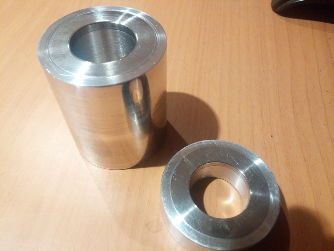

Nothing too exciting. Spent some time on the lathe last night and modified my Vulcan pulley adapter. Faced it off to 1" thickness and reprofiled the register boss to fit the stepped bore in the pulley. Also tapped the 7/16-14 holes thru. No pics. It's out in the garage and I'm lazy. I was painting the brake rotor and pulley and needed it for the masking.
Also made the final axle spacers. 1.5" OD x .755" ID 6061 aluminum with .107 thick stainless inserts pressed flush into the bearing interface end.

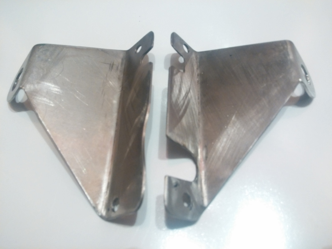

Got the Mikuni carb "hidden" brackets fit up over the last two nights. Still need to blast and paint but here they are. Kinda ugly but they are barely visible. They bolt to the back of the carb and wrap around the sides to anchor at the breather holes using Lowbrow breather bolts. I'll get more pics as I get them painted and installed...
They are .050 stainless and really stiff. The breather bolts pull the carb down into the gasket with not a hint of flex and I can rock the bike back and forth on the lift using only the carb.
