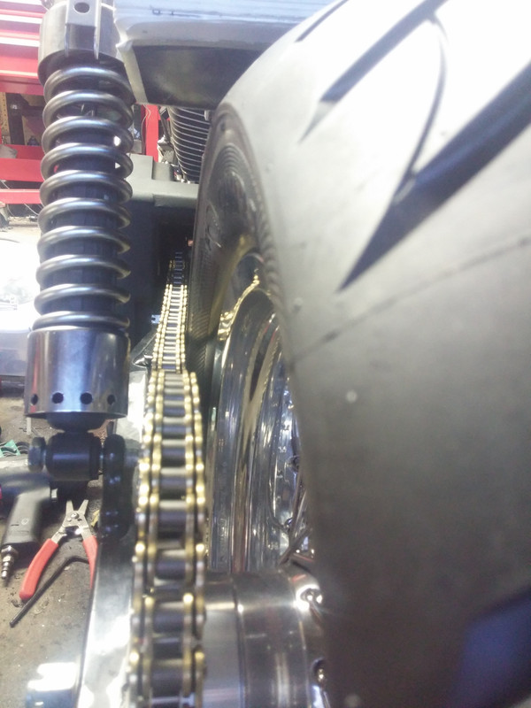

Also finally tore off the primary to get the sprocket fit up. Based on my research of people with slightly newer Dynas I gambled that a .750 offset front would work. Not even close. Even with the 3/4 on there it still measures 5/8 too short. That would hit the inner primary so I ordered the 1.060 offset from PBI. I'll have to make up the difference at the hub. Think I'm gonna have to offset the tire. Bummer. I wanted it centered in the swingarm. Will make new axle spacers, shorten the pulley adapter/spacer, and maybe modify the rear caliper bracket... No wonder I couldn't find anybody doing this to a '99. Oh well. Adapt and overcome.

Well damn. I got the 1.060 sprocket in and I would still need to offset the tire at least 1/4" to make it work. PBI says the 1.06 is the widest that will fit under the 5 speed primary. I'd tend to agree. With some modification of the inner primary I think I could squeeze another .100 out of it but that would sacrifice quite a bit of strength of the mainshaft outer bearing carrier. Probably not a smart mod.
That leaves me with three options as I see it...
1) Offset the whole primary 1/4" and get the 1.125 sprocket.
2) Live with the tire offset and change the brake to make that work. Maybe a sprocket brake?
3) Go to a 180mm tire.
I need to do some more thinking...

I would think the sprocket/rotor would work running no fender or even a short rear fender, if your rear wheel isn't perfectly in the center if the swingarm, you think it would be a issue? that I don't know. I do have to say, im glad you bought the 1.06 sprocket so know I know lol
