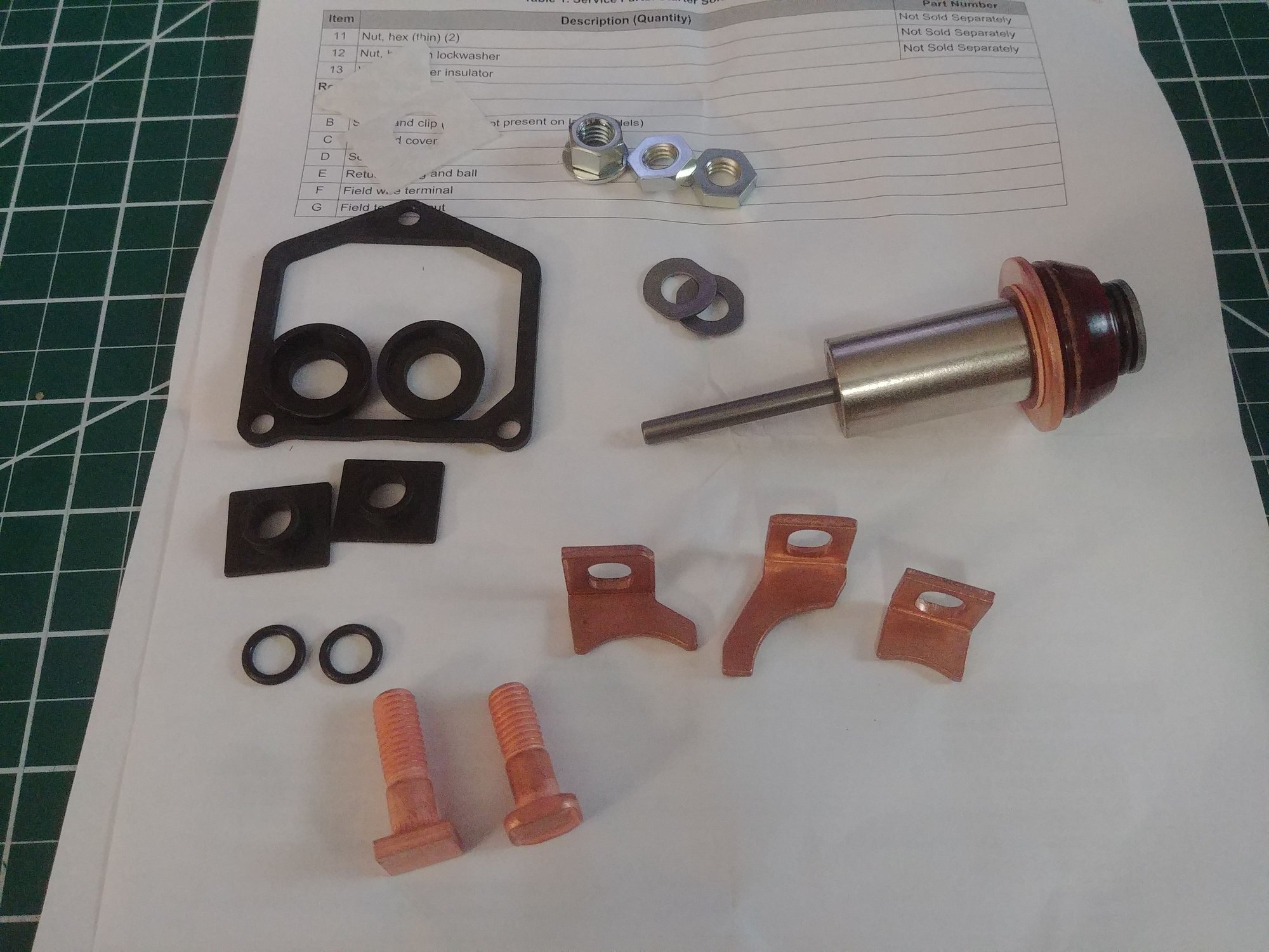

...Decided to hit up the big Harley dealership (Fort Wayne Harley) figuring they would have the solenoid rebuild kit. Waited in the parking lot until they opened. They didn't have the kit. Made some calls. The little shop nearest to home did have two of them, tho. Another hour+ drive to Jims Harley, Mendon, OH. They also had the starter terminal so I picked up that too (I guess have a spare on the way now) $65 total.

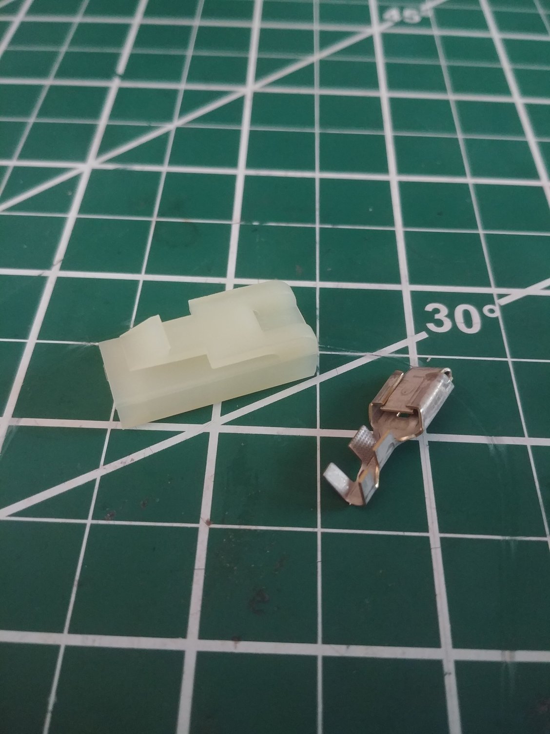

I should have plenty of wire left but I think I'll need more terminals for the 5/16 lugs. At least now I know the correct wire lengths and terminal orientations so I can build them off the bike.

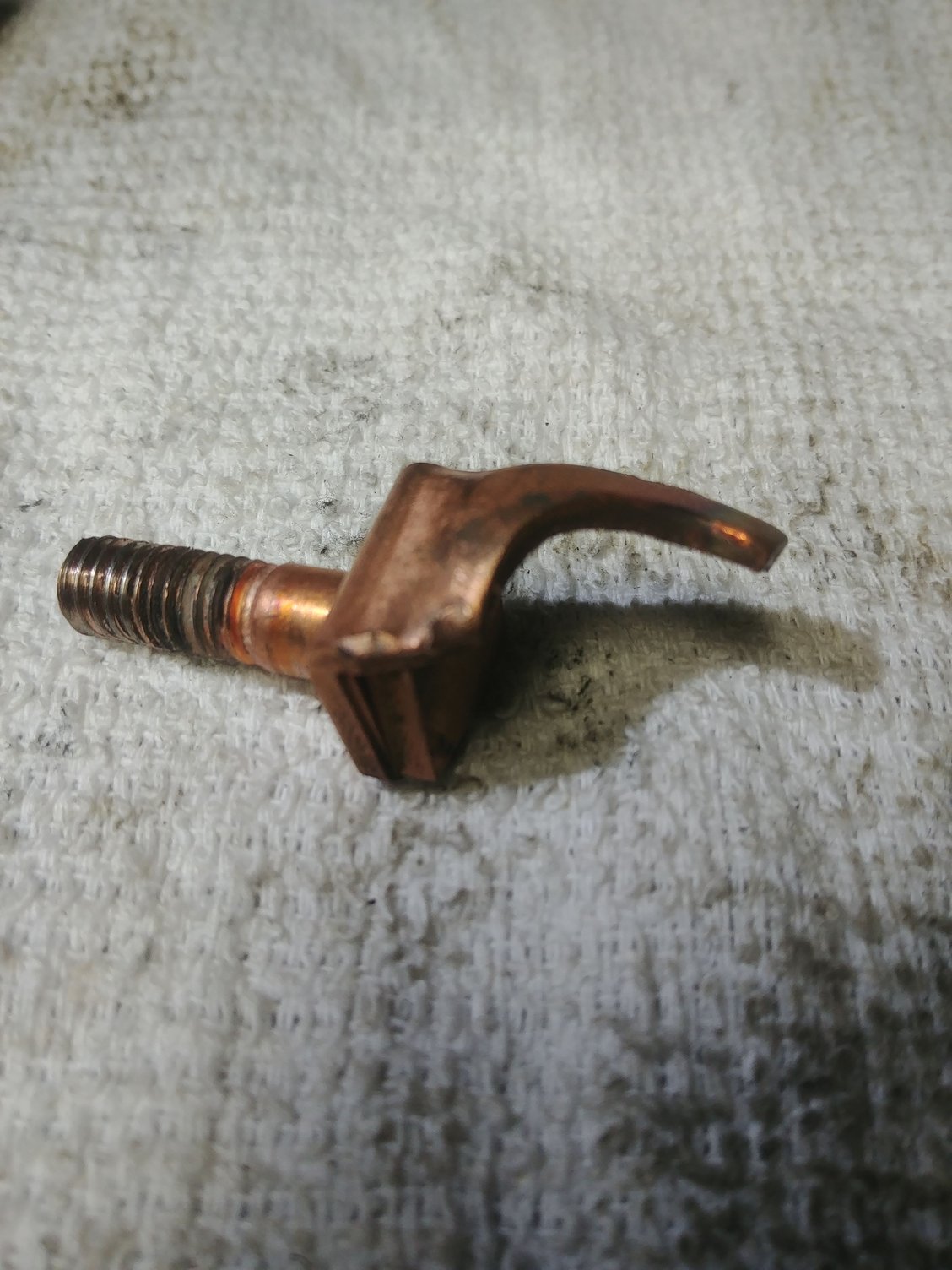

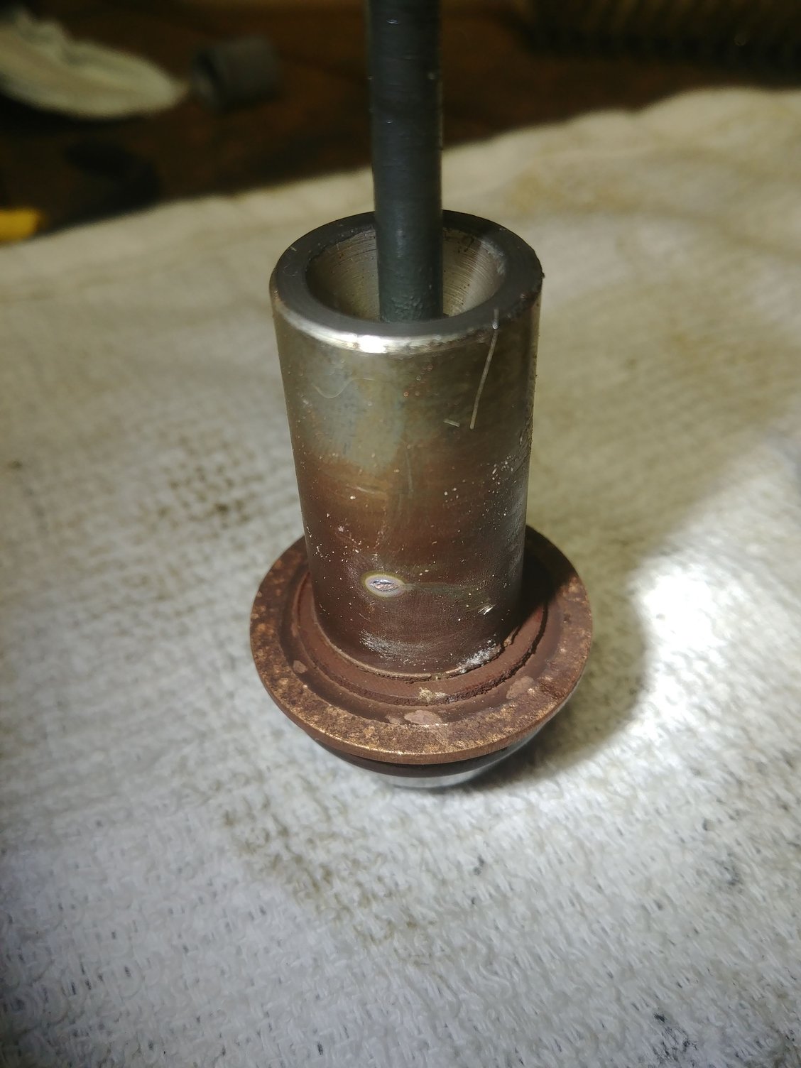

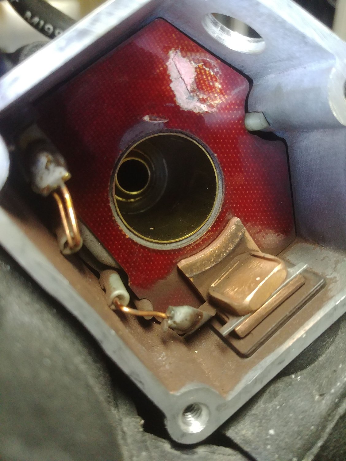

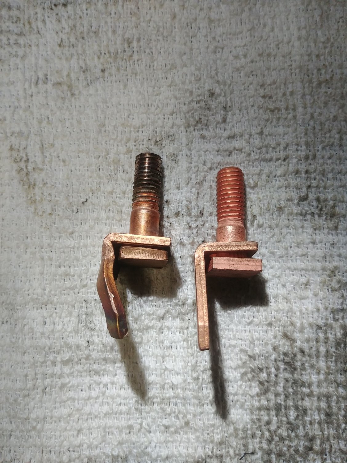

Some pics of the solenoid internals...
Plunger is scored and pitted from the welding arc. Contact ring was pretty beat up anyway so a rebuild was coming due regardless.
This damage really concerns me. Cracked and deformed insulator. Possible hidden winding damage? Pretty sure that's not serviceable.
The contact that twisted. I clearly strong-armed it and didn't realize it. Stupid! Notice the color change from the heat..

Anybody need a brand new solenoid rebuild kit? LOL
