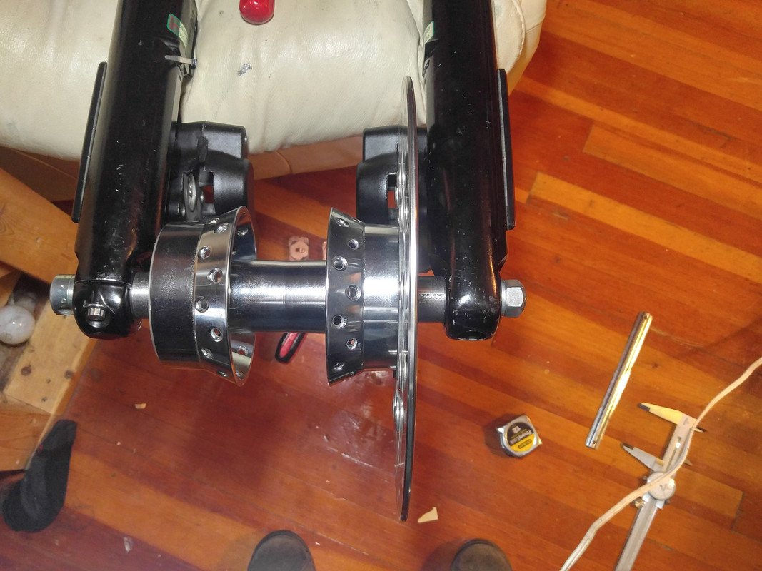

OK... I think I'm finally satisfied with my measurements. They all seem to jive with Multihdrdr's except the lateral caliper offset from the slider centerline. Both seem to be about .060 (.0625?) to the left of where we think they ~should~ be. Hmm...
Anyway, for those curious and for my reference later. This centers the tire/rim in the forks so I don't need to offset the rim when I lace it and it sets the rotors in the centers of the calipers Custom spacers and hub required.

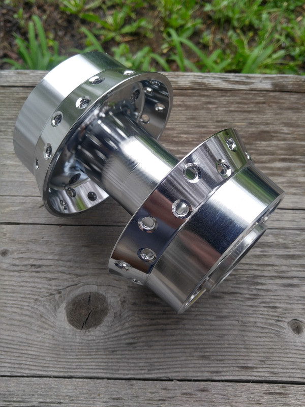

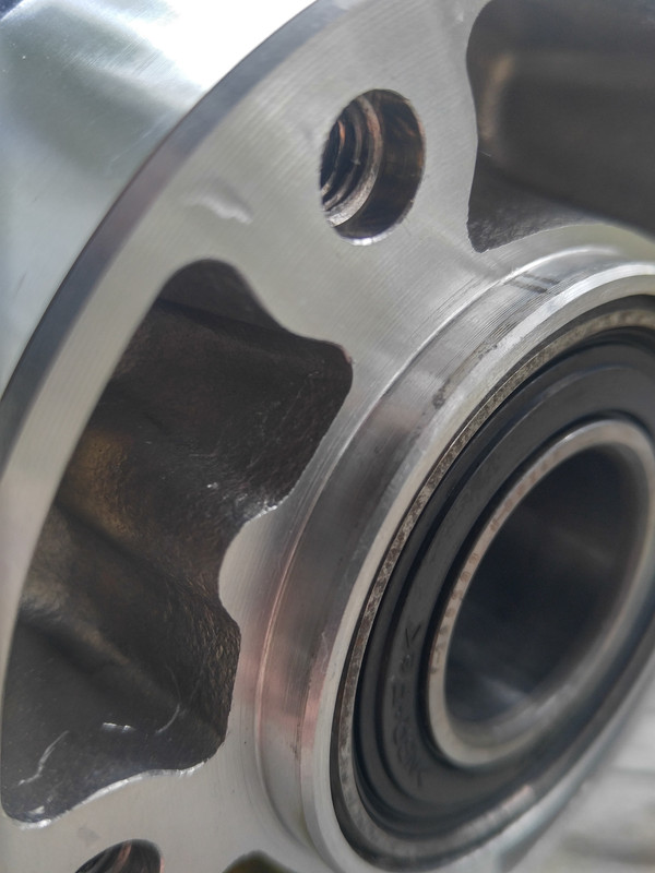

...and one customized hub. I didn't get my axle spacer stock Friday before the shop closed so I'll make the spacers next week.

Fits perfect.
