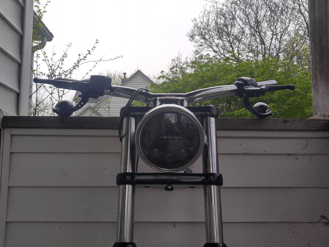

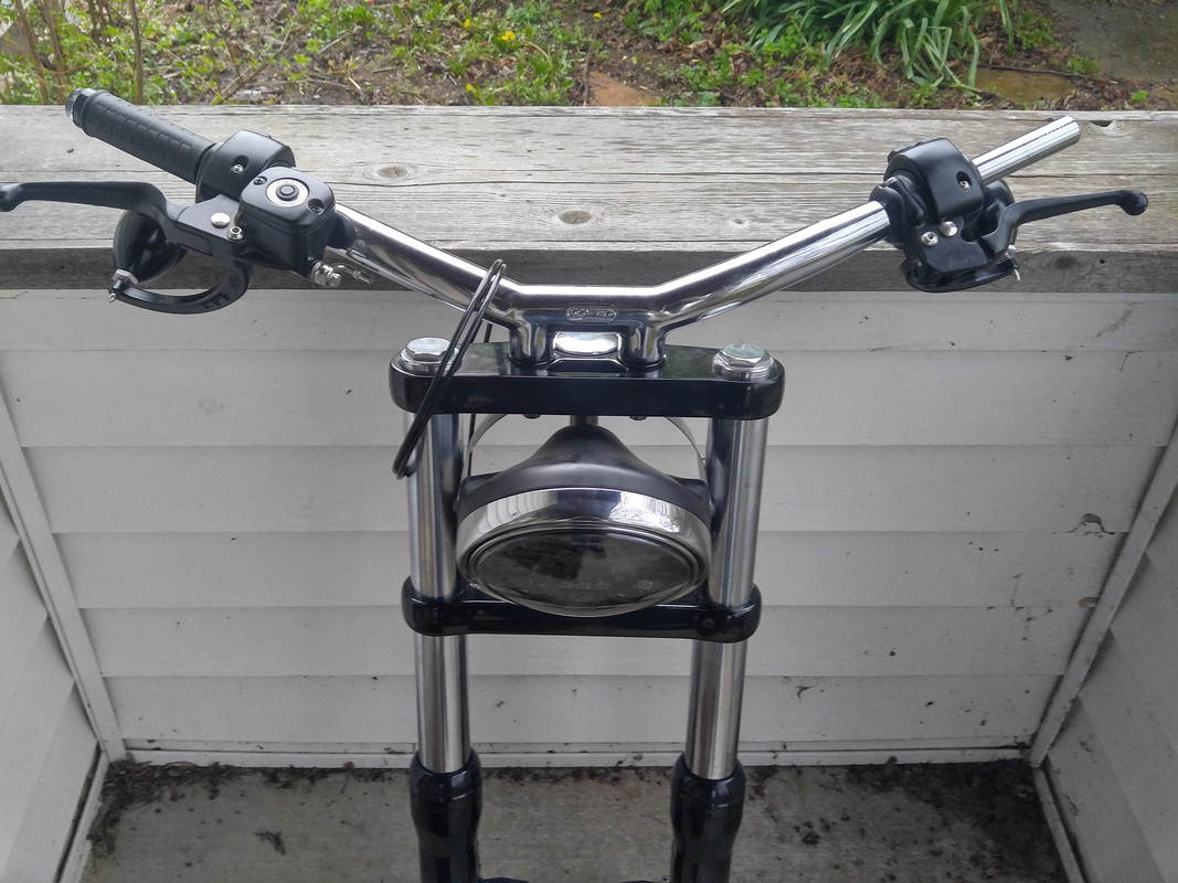

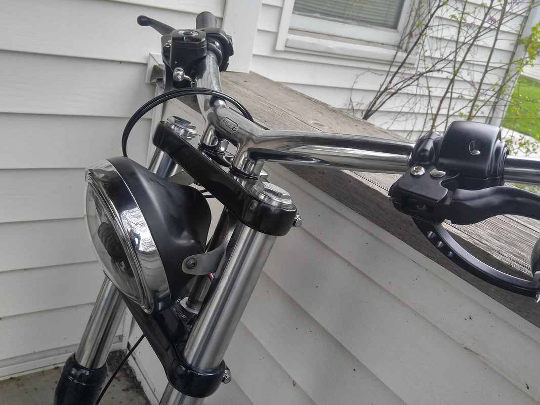

Mounted up. Thoughts? After four or five different bracket designs, I think I finally actually like this one. The others I was just "meh" about.
looks good. will it become black?
The bracket? Yeah, I think a black of some type would be my first choice.

It looks really nice, very clean. Is it sturdy as is?
Also, the Carlinis look awesome!
Honestly, I wouldn't hesitate to run it as is (painted). It's stronger than I expected and I didn't even bolt down the third (bottom/hidden) bracket. With .050 stainless it would be damn near bomb proof.
So far I'm diggin' the bars. Was originally going to have the powder coated but once I.started getting parts on it the chome started looking better and better. I'm not going to make a decision until I get the front end hung on the frame. I'm still a little concerned about the grips or controls hitting the tank, but we'll see. The CAD model says it should clear but some of my model geometry is pretty rough.

Nicely done, sir!
+1 on F86's comment - maybe a heavier gauge on the material, but the 'curve' compliments the mirror brackets. Cool.
