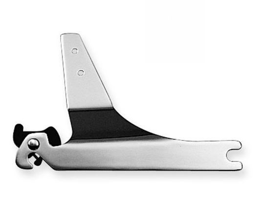

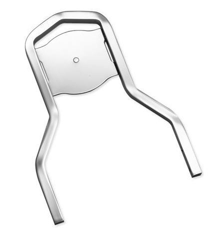

cg, it seems you can never "win" these. You can provide facts, but it doesn't seem to make a difference. Either they can/do "get it" or they don't.
...and really, it doesn't matter.
But I'll give it one more shot...
http://www.harley-davidson.com/store...-01-5290902--1
Fits '04-later XL models equipped with Rigid Sideplates. Also fits '02-'05 Dyna® models equipped with either Rigid or Detachable sideplates.
http://www.harley-davidson.com/store...-01-5354395--1
Fits '96-'05 Dyna® models (except FXDWG and FXDXT).
