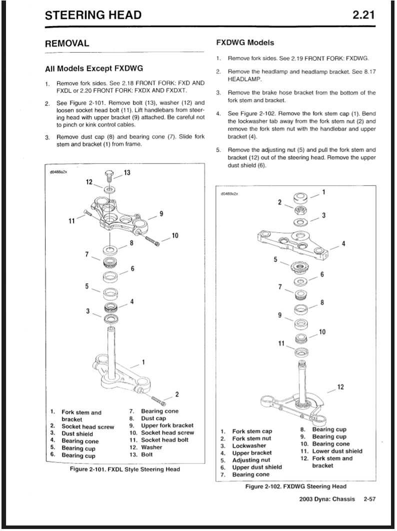

So I've developed a speed wobble at around 90-95 mph so I would like to check my fall away. (03 FXD by the way). I have a manual and it says to tighten or loosen the fork adjuster nut/bolt....and I have no idea where/what that is. And the microfiche I found doesnt label anything as an adjuster nut or bolt. Every video I've seen online has a steering stem nut with the adjuster nut underneath. However mine has a bolt instead of a nut and cannot find a similar adjuster nut anywhere.
Any help would be appreciated. Thanks!

you can see on the right side (the wide glide side) there is an adjustment nut clearly labeled....nothing on the left

#13 in the left pic...if you have a stock '03 front end, which has 39mm tubes. The wide glide uses 41mm forks from the FLH's... Follow procedure in service manual carefully.

Indeed like sharkey said, #13 is your adjustment... the pinch bolt, #11, is what locks the adjustment in place.
