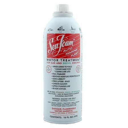

Or good old seafoam in the gas every now and then
Took it with me last week on the road trip to counteract the shady gas stations <br/>
