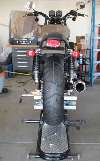

I think that if you look closely at the Dyna frames up to 2005 including the later Evo dyna frames most of the basic dimensions are the same. The part number changes are likely from a added bracket for wiring / brake line or some other change.. I installed a 180 tire on a 2000 FXDX and was able to get the tire to fit by simply heating the fender brackets up with a torch and bending them out so that I could fit a 7 1/2 inch fender in the back.. I used an 5.0x18 inch alloy rim (Revtech) on a stock HD hub. Stock rim size for a 180 tire is 5.5 inches.. It's a tight fit but it worked out real well. Bike actually handles way better then when it did with a 150/80x16 on it.. Some of that was probably changing from steel hoops to aluminum. Tires feel neutral all the way to bald.. With the 150, bike wanted to stand up in the corners as the tire wore and it would start to wobble at high speeds as the tire wore out. Prior to the rear wheel change, I tried everything, sputhe stabilizer, PMFR steering damper. Bike is a DX so it has good suspension.
Bike already had a chain as I was worried about breaking a belt.. It has an older 116 ci SnS crank and cylinders (4 inch bore x 4 5/8 stroke) that makes over 125 hp. Good thing was that it stopped breaking the tire loose off of stop lights..
