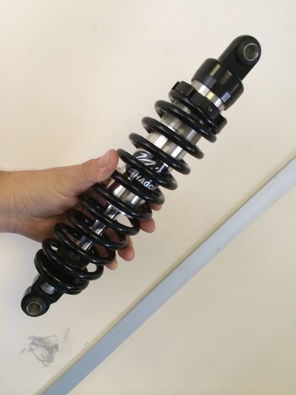

I'm running 13" Hagon Nitros. Purchased 2 years ago. Then, they were $500, I think they're somewhere around $550 these days. I was also considering Progressive 444's. Went with the Hagon since they build them specifically for your weight, riding style, etc. Like the 444's, they have adjustable preload. Unlike the 444's, the Nitros have dampening adjustment. Futzing with both preload and dampening has allowed me to really dial in the shocks for me. Also, went with 13" shocks since they have 3.2" of travel vs. the 2.1" of travel in the stock shock. In reality, since the shocks are at an angle, they only lift the rear about 1/2"...barely noticeable. Having said that, I think due to the slightly increased height and because of the shocks themselves, I find it's rare I scrape the floorboards in turns where previously I was scraping notably more. I would emphatically recommend not going shorter than stock length as ride quality will be compromised.
This.
I also vote for the Hagon Nitros. Pretty much the best you will find for the money and fully adjustable. Call Hagon and talk about rider weight, riding style etc. They will build them to this spec. Black and other colour options available to suit....
13" will give a much better ride than the stock 12" as well.

I will pass this all onto her. She lives in Cardiff, near Encinitas which is about half hour ride to San Marcos where Hagon Shocks are located. I think that will be her first stop.
