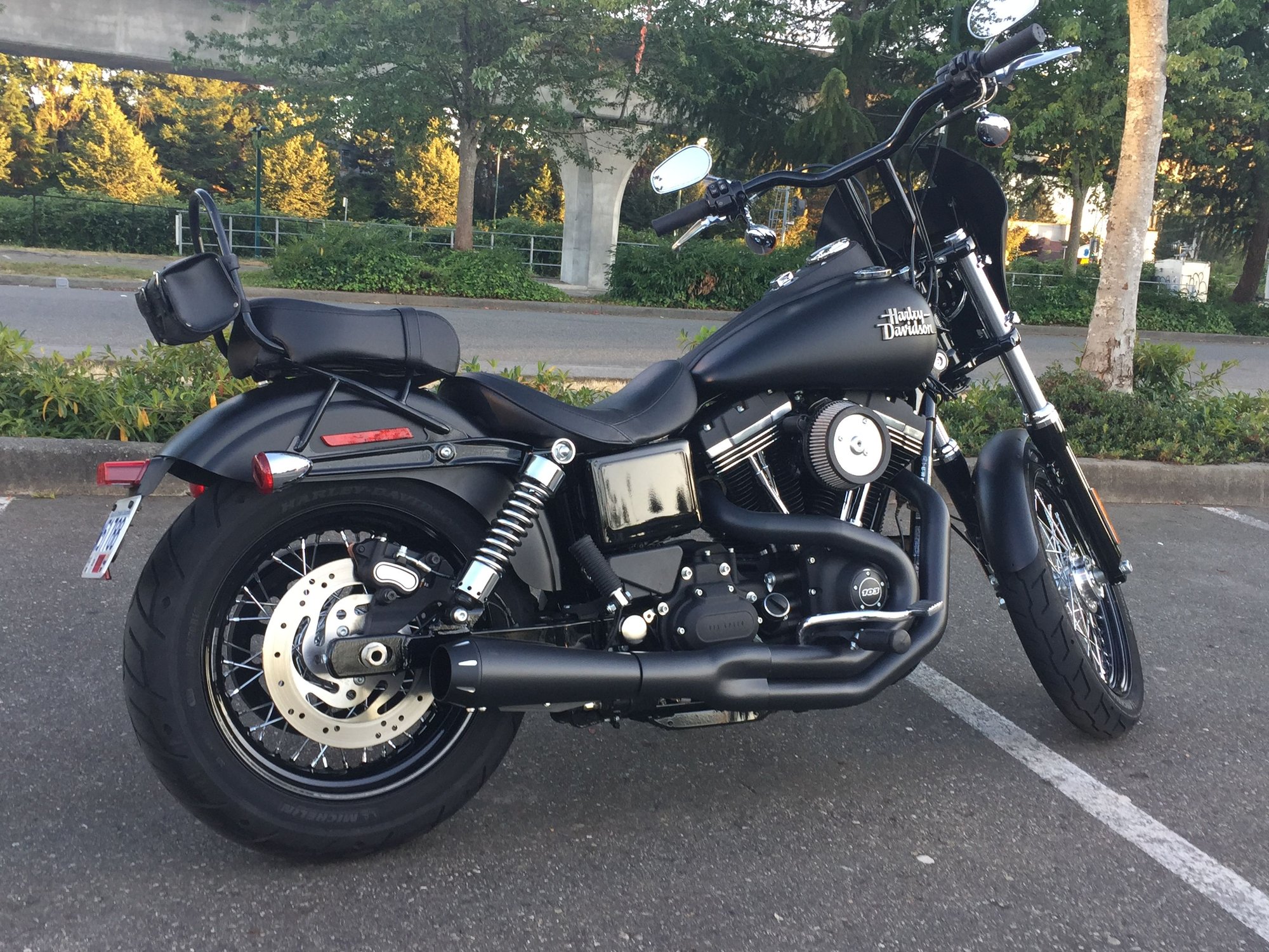

I just put the RR 2 Mega Power on my 2016 Street Bob. One word - LOUD.
The sound clips on You Tube aren't really a good representation of the exhaust sound. Plus, you will definitely have to use a fuel management system. That's a whole other discussion....
I use a Street Tuner but the bike will have to go back to the shop for some fine tuning. It pops and backfires on deceleration a bit too much for my liking.
Fit and finish seems ok. But only time will tell.
I did notice a loss of bottom end compared to the stock pipes. The dyno time should sort that out a bit, but shorter pipes do move the torque curve.
I met a guy who had a Sawicki on his Street Bob. Really like the sound but way too pricey! And long wait time! But he also had to do major retune to get it running right.
