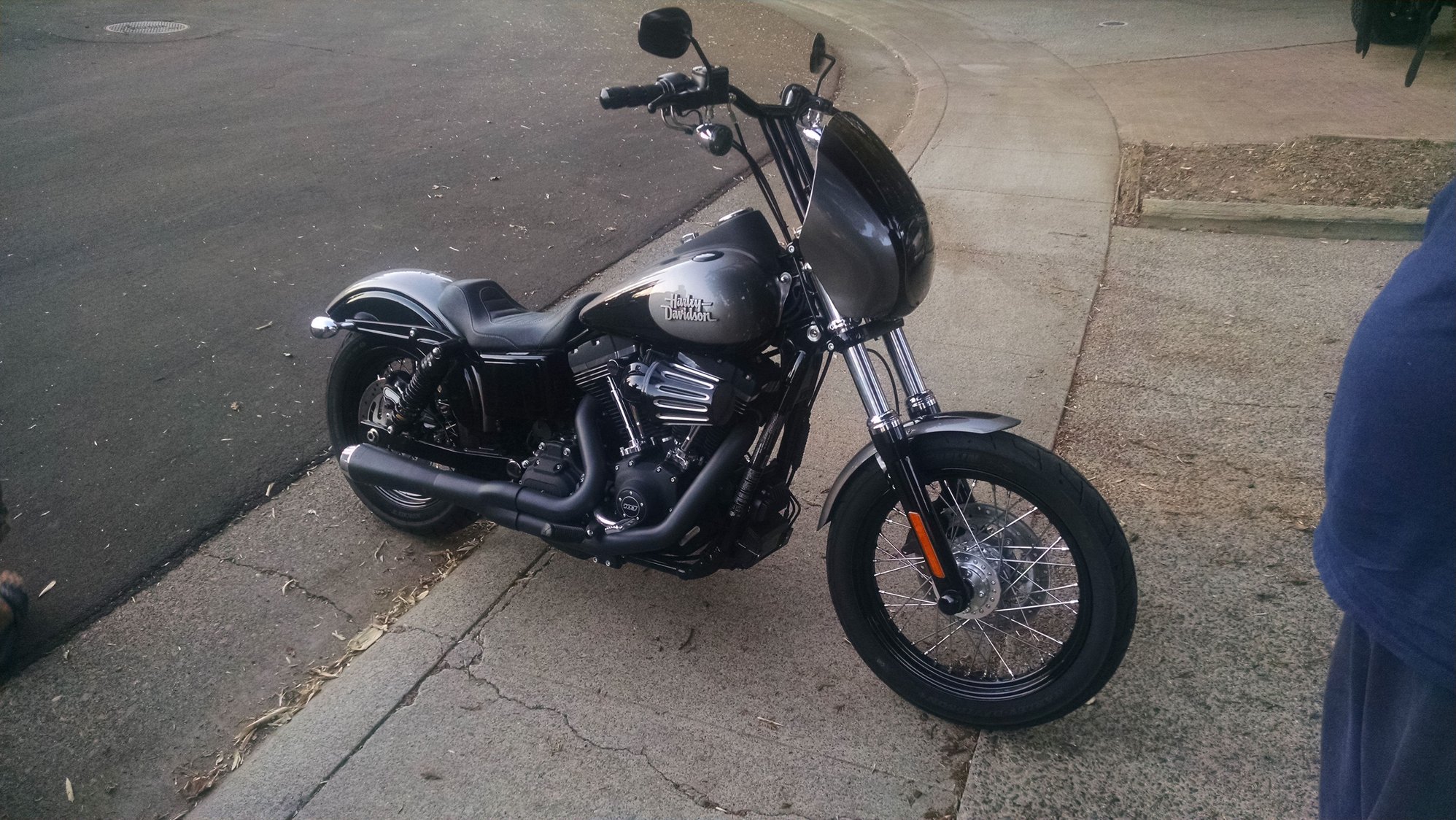

Mine is the Harley one but this will give you a idea of how it looks on our paint color.

That looks fantastic. How functional is it? Any pics from the front? I am trying to work the paint scheme out...

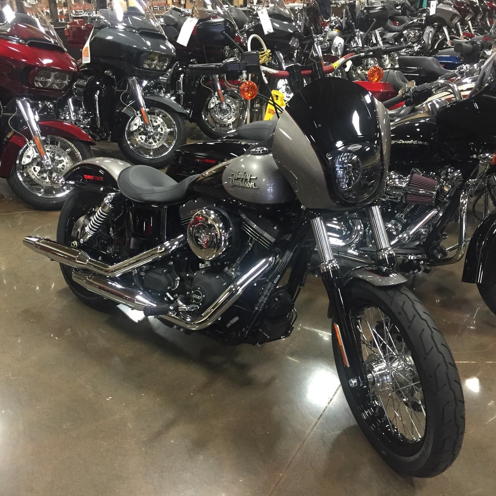

This one is one that I seen at a dealership. The paint rounds of at the bottom unlike mine which goes straight down.
This one is mine.
