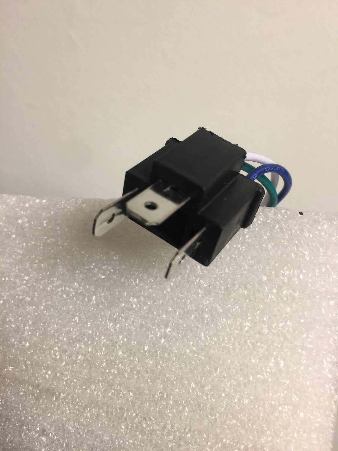

I purchased a set of these Retro fit bulbs for my 2008 . The guy at my local HD shop told me they were a direct fit that they've been installing them on other bikes - cheaper alternatives to the Daymakers . I didn't buy them there , I got them off Amazon . When I found time to install them , I ran into 2 issues ( 1 ) plugs didn't match ( 2 ) the adaptors to hold bulb also didn't work . I contacted the seller and maker and they where both pretty much clueless . Has anyone tried to upgrade the bulbs on their headlamps ? Which type did you use ? Thanks .

Fat Bob takes H13 bulbs not H4. Not gonna fit.

Thanks Joe , I figured that out last night

Moons makes a h13/h4 adapter.

Thanks guys , I still can't use those because those bulbs can't fit my housing . I already had contacted the seller earlier this year and told me to send them back . I found other bulbs same style that will plug and play .
