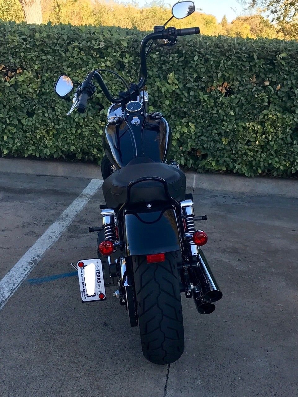

6th Gear
Joined: Oct 2016
Posts: 12
From: Dallas, Texas
Here's mine. Was super easy to do with the stock mount. Just rotate the inner frame vertical and then reattach the plate. I think it looks way better than horizontal.
