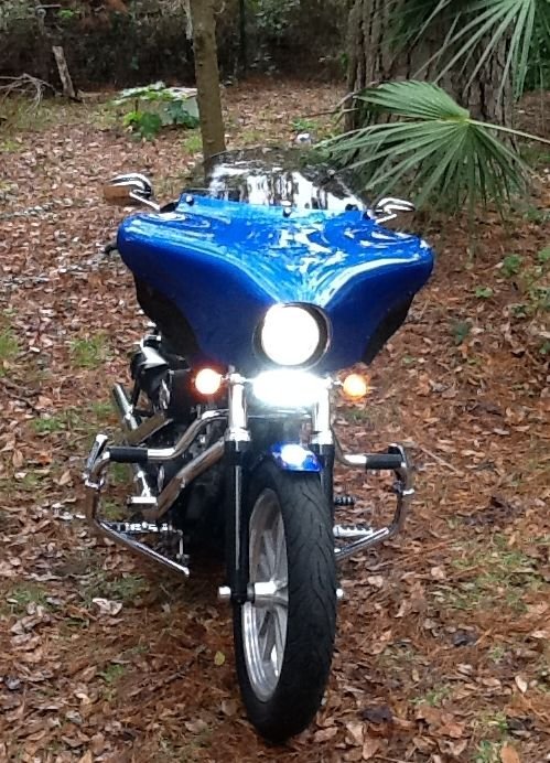

I directly wired it into the headlight power without a switch, so it is on all the time but I am considering adding a switch but haven't decided yet

I wired mine to a push button switch under the front left side of the seat, It does help at night and is more noticeable than the headlight

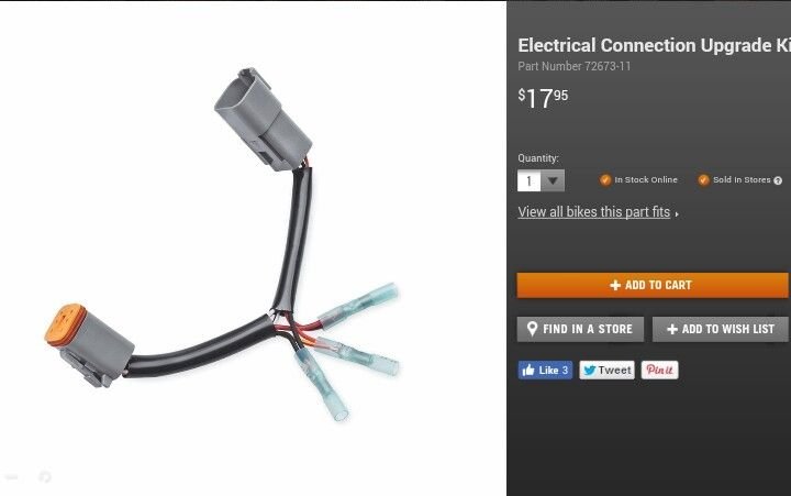

I did the Harley pigtail since I didn't want to cut any factory wires. I ran my wire inside of the frame and out the right side at the neck and down the break line to the light.

Btw you can buy the same switch and harness on eBay for 1/4 of the price.

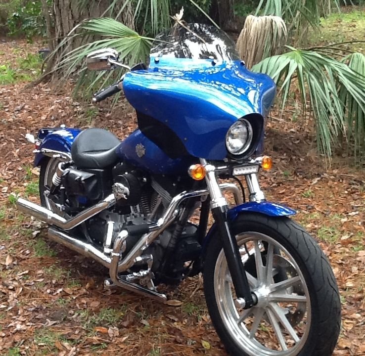

I wired it direct to the high-beam wires, inside the headlight shell, using posi-taps.
Took about five minutes. The posi-tap means that you don't need to cut wires, and they can be removed with no damage to the wires (the pinhole in the sheathing closes up but I put a drop of silicone just in case).

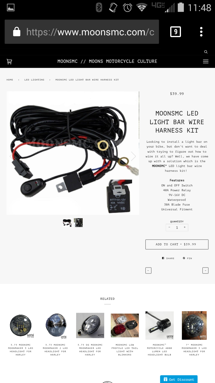

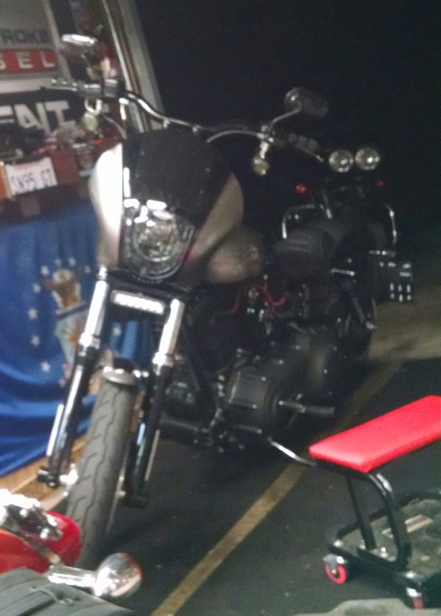

I started a treadmill similar a while back. I got a relay with separate switch. I added the switch to the left side of the dash. Ran the wires under the dash and seat. They're really long so I cut and spliced them. Turned out really clean.
I thought I had pictures of it, but I don't. WRKD4ITFLHX2008 posted a picture on my thread of his push button which is where I put mine but I used a toggle light up switch.
This is the light harness/relay I got
https://www.superbrightleds.com/more...nel/1753/4083/
This is the switch I have
https://www.amazon.com/gp/aw/d/B000C...X00XTDWBTGYXXA

I wired mine to a switch I added to the console. I think I have it in my build thread
