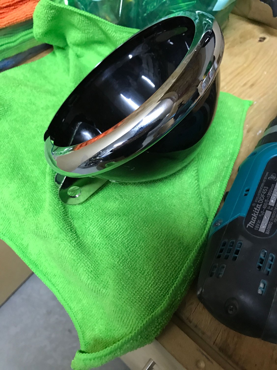

I have a black bottom mount bucket sitting around

Originally Posted by emperor wurm
with the block?
just the bucket

bucket and ring . No hardware . They aren't $40 on eBay .
