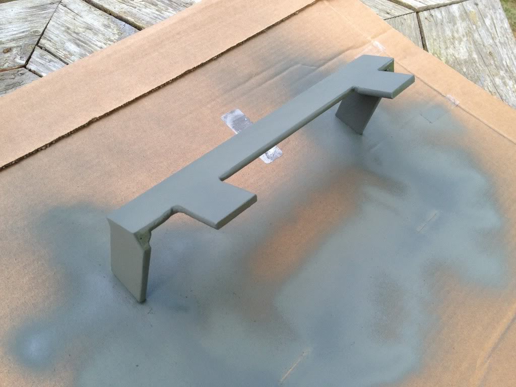

I didn't use Softy brackets, I picked up a set of used Street Glide brackets for around $30 I think and made a bracket to secure the front part.
New hole and threaded insert
New hole in bracket for mounting
Bracket for under the seat
Support hanger
Rear crossover brace

Blueangel73, it appears you only have one versus two normally mounts for the bags them selves? How did you secure the front of the bags?

I used the softail brackets cut the tops off and added a flat bar (welded) to mount it to the fender strut. Also mounted the front part of the bracket simulare to blueangel. And also made a rear crossover brace. Was on a 11 street bob.
