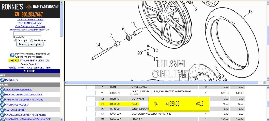

Originally Posted by blueangel73
You are more than likely correct about the axle, I was basing my info off of what I pulled up on Ronnie's Parts Finder which has the 41628-08 axle listed for a 2010 Wide Glide.
VVVV Now What? VVVV

Originally Posted by cggorman
I've found errors on Ronnie's microfiche before. St. Charles microfiche used to be leagues ahead, but they recently changed format and lost a LOT of good info (Bolt specs!). Can't speak to the accuracy yet. Wish I could find another site as good as St. Charles' used to be.
It's about the "Backend"...
Ronnies and NOW St Charles use HLSM, you probably are looking for ARI (st charles used previously).
Another that uses ARI ...http://shop.outpostalaska.com/OEMpartfinder.htm
