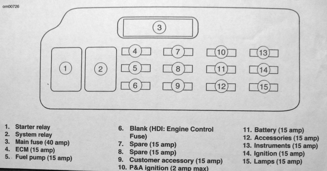

just as the title says a 2012 WG. I know there is a starter relay somewhere on the bike. i have been told it was in the fuse box but it not in the fuse box. dealer did not have any diagrams showing the location of the relay. any one any one can help, please?
i just can not start the bike and i hear a clicking when attempting to start the bike. battery is brand new and the battery has been tested, all wires have been checked
any help please. a picture ? a great description of location of the relay.

this should help
