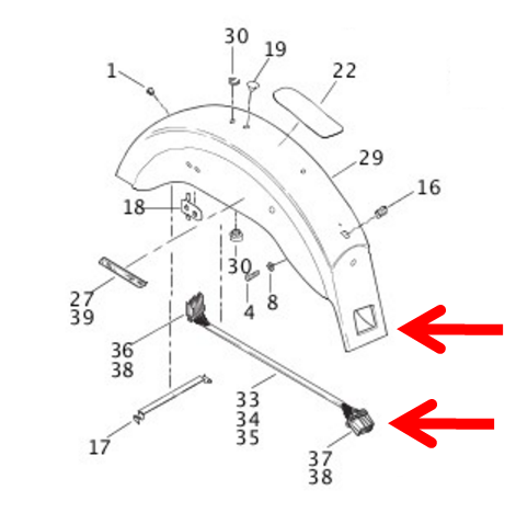

2003 Dyna Super Glide, looking for wire location for the break light and plate light. where would be the best place to tie in for my new side mount?

Front side of the rear fender where the main harness meets the fender harness.
