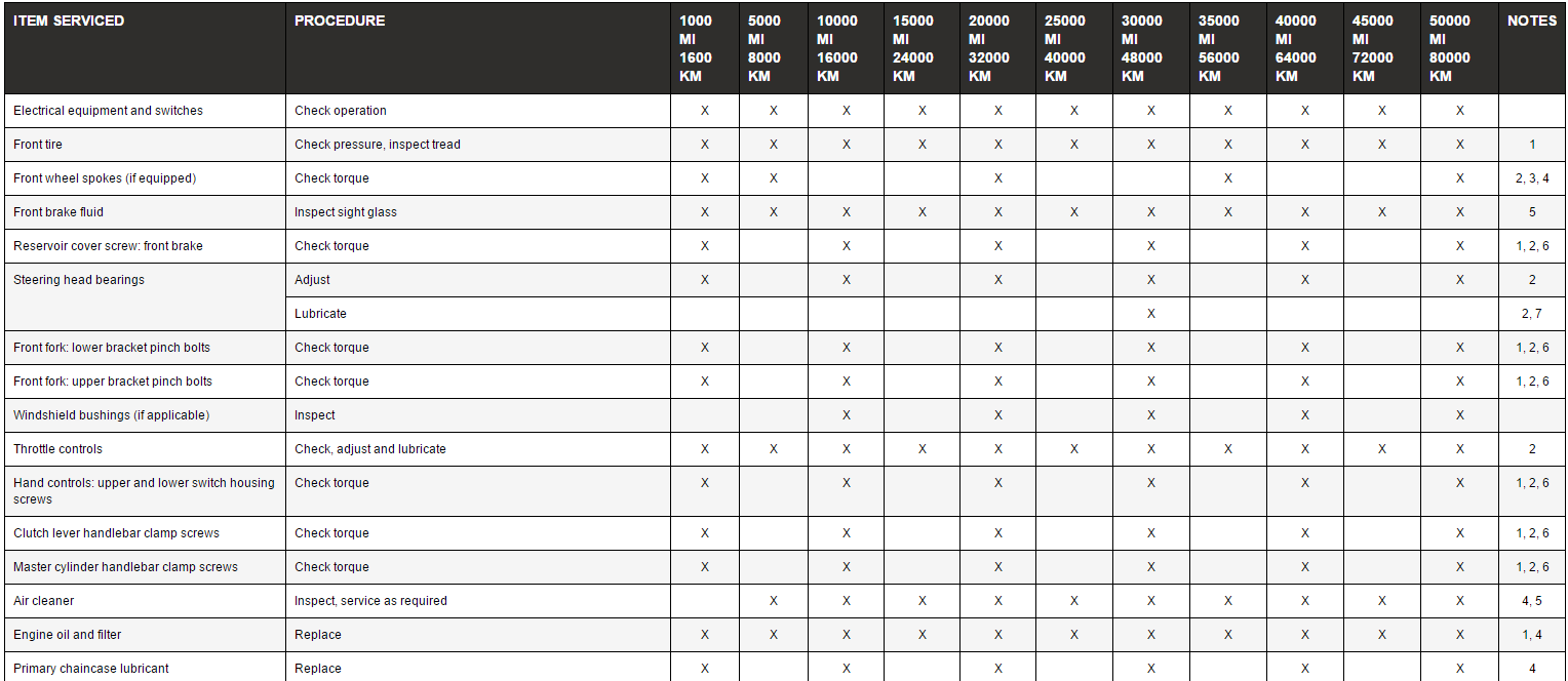

change your oil as much as you want. as long as you don't let it go too long.
free online:
https://serviceinfo.harley-davidson....397639!!0!6694
