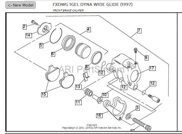

You must have forgotten...why would a caliper with a single piston be considered having 2 pistons?
Do you have 1 wife (or girlfriend) or or do you say you have 2?
There is one piston on each side. Hence 2.
4 piston calipers have 2 on each side.
6 piston Brembos, 3 on each side and so on.

CG, I bet you could see this coming Sorry, but I tried to make it short and simple before
What I find interesting is that you don't check your facts before responding to contrary information...not once, but twice
Here's your 97 front caliper...show me the second piston
...Remind me to NOT have you do any counting for me

Originally Posted by Architect
...6 piston Brembos, 3 on each side and so on.
I'm also curious...what "6 piston Brembos" would you be referring to?

Originally Posted by cggorman
That looks familiar! Can't wait to get some real brakes on mine.
The 99 is kind of an odd duck. Part Evo, Part Twink.
Yeah, and you only had 1 up front
Interesting that Dynas went back to a floating rear caliper in 2008, although it was 2-piston instead of a single piston (both pistons on one side Architect, is that a 4-piston?)

Well man enough to admit when I am wrong, one piston it is, checked my manual as well no arguing that point.
That said, when the change over in brakes happened in 2000, standard terminology was two piston vs four piston. Old calipers were referred to as two piston, where we all wrong, I guess so. Learned something. Continue with the original conversation.
