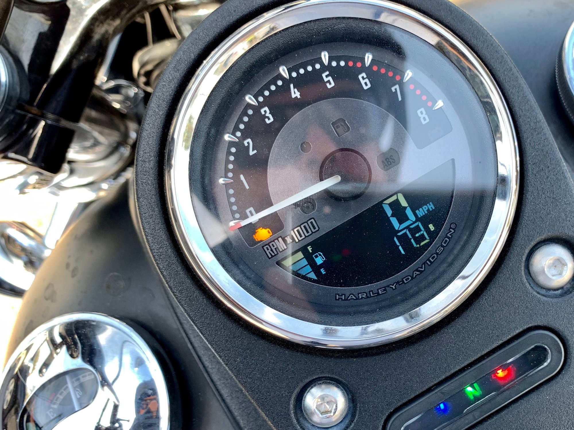

2017 Street Bob (FXDB), removed the canister and tubes and solenoid, went out for a ride, got the check engine light.
I'll put the solenoid back on when I get home, kept it with the two tiny hose pieces on it as seen.
Hopefully that fixes the check engine light, unless I'm missing anything?

OK, I got home, capped off the two ports in the Solenoid, and reinstalled it...no more Check Engine light (edit: replaced screenshot with real images):
