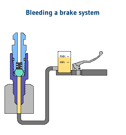

Originally Posted by stonei3
I'm sure you've touched on it before but I can't recall which thread. Do you have any experience with speed bleeders? I've tried them out and wasn't much of a fan. Struggled to get a constant flow more so than a conventional nipple - (Queue Multi's gutter response). Bleeding dual calipers is a pain and if something works I'm all ears. Thanks
Well since Multi wimped out on his response, let me just say Stahlbus bleeders are almost as much fun as cocaine and hookers . Stahlbus bleeders work like this...
The bleeder is two parts with a O-ring seal, sealing the upper and lower halves, it can't leak air like speed bleeders that use sealant on the threads and won't wear out the taper seat in the caliper. Well worth the money, I have spent many hours fighting with conventional speed bleeders and there is no comparison.
Link: https://www.stahlbus-us.com/
: Mike
: Mike
Cocaine and hookers are pretty damn fun. Right on Mike. Much appreciated. Enjoyed the graphic as well! I will likely give them a whirl.
