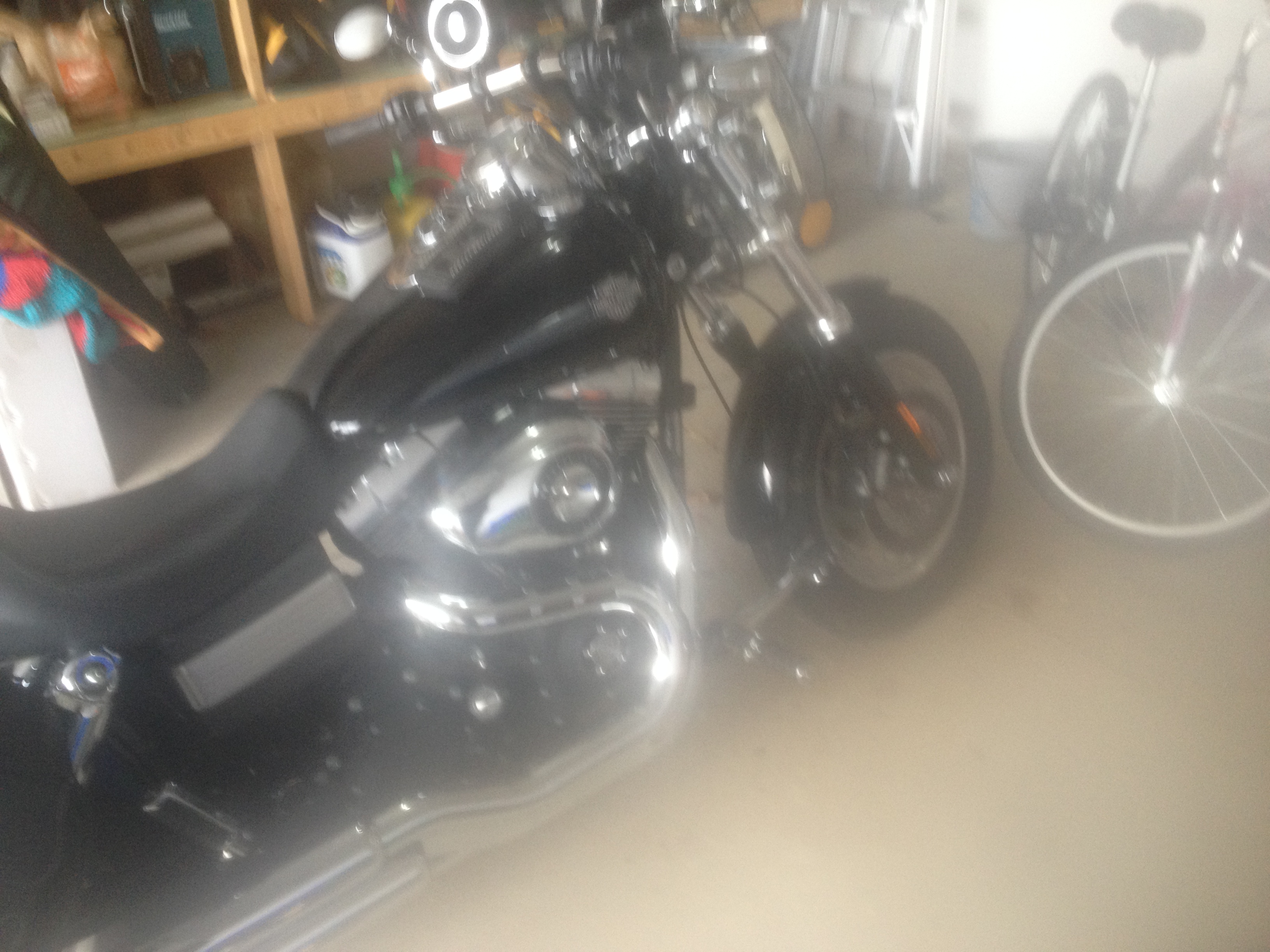

If you have this model and put some floorboards on it PLEASE tell me which ones you used. Also please check out the pictures to see the pipes im talking about!

Just get yourself a full exhaust headers and pipes, or just headers only from a Streetbob etc, and then buy the Harley floorboard kit it is a straight bolt on, and it is brilliant.

Yea, what smog said. The main reason why the Switchback footboard kit (PN-50500247) won't fit your bike is do to the header pipes routing. As Smog said, get so stock Street Bob pipes (I am sure you can find a good deal in the classifieds here) or get a new complete system. When searching, make sure they fit a Switchback so the front pipe is routed correctly to provide the clearances you need for the boards.

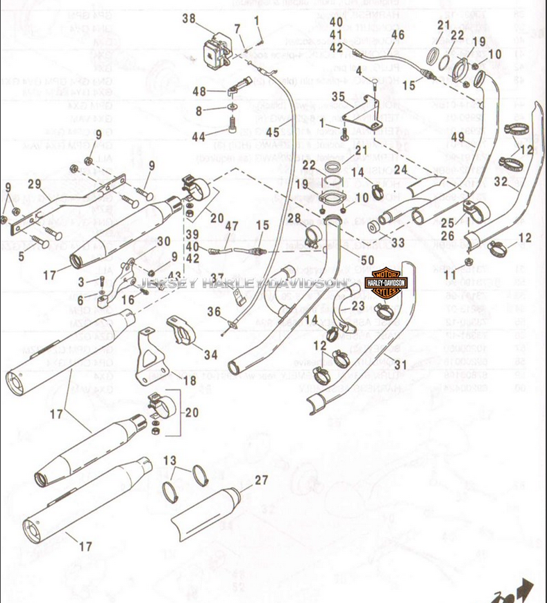

Just like blueangel73 said, if you already have the floorboard kit from harley, you will find a set of headers or full exhaust on Classifieds or fleabay for no more than 200 dollars, then all is a straight bolt on, only thing you will need to buy separate is the little bracket and screws that bolts under the engine. the number is 35 on the picture below.
