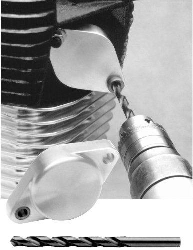

Some of the stud removal tools work with a ratchet and tighten more as you turn.
If you end up cutting the rest of it off flush, use the flange as a guide by bolting down on the good stud. This will give you a fighting chance at staying centered on the stud as you drill.

If you find yourself having to resort to a drill, consider a proper bushed drill guide. Jims makes one, probably others as well.
