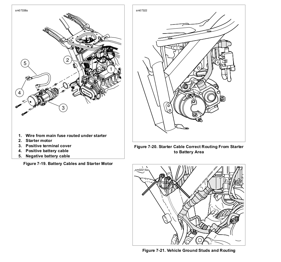

Old Jul 21, 2017 | 06:35 PM
Smogbob's Avatar
Smogbob
Joined: Nov 2016
Posts: 666
Likes: 95
From: Berlin
Originally Posted by jorgester02@yahoo.com
I checked the cable-to-battery connection. Both positive and negative.
i did not check the opposite ends of the cables. The bike was too hot to dig around on. I am not familiar enough as to the exact location for the ground and positive to check them with out some investigation.
maybe this will help.

Old Jul 21, 2017 | 09:27 PM
jorgester02@yahoo.com's Avatar
Joined: May 2016
Posts: 141
From: Omaha, Nebraska
Thanks sir! this helped tremendously. I assume this came out of the service manual? I have one of these in the garage, didn't think to look at it for the figures.
