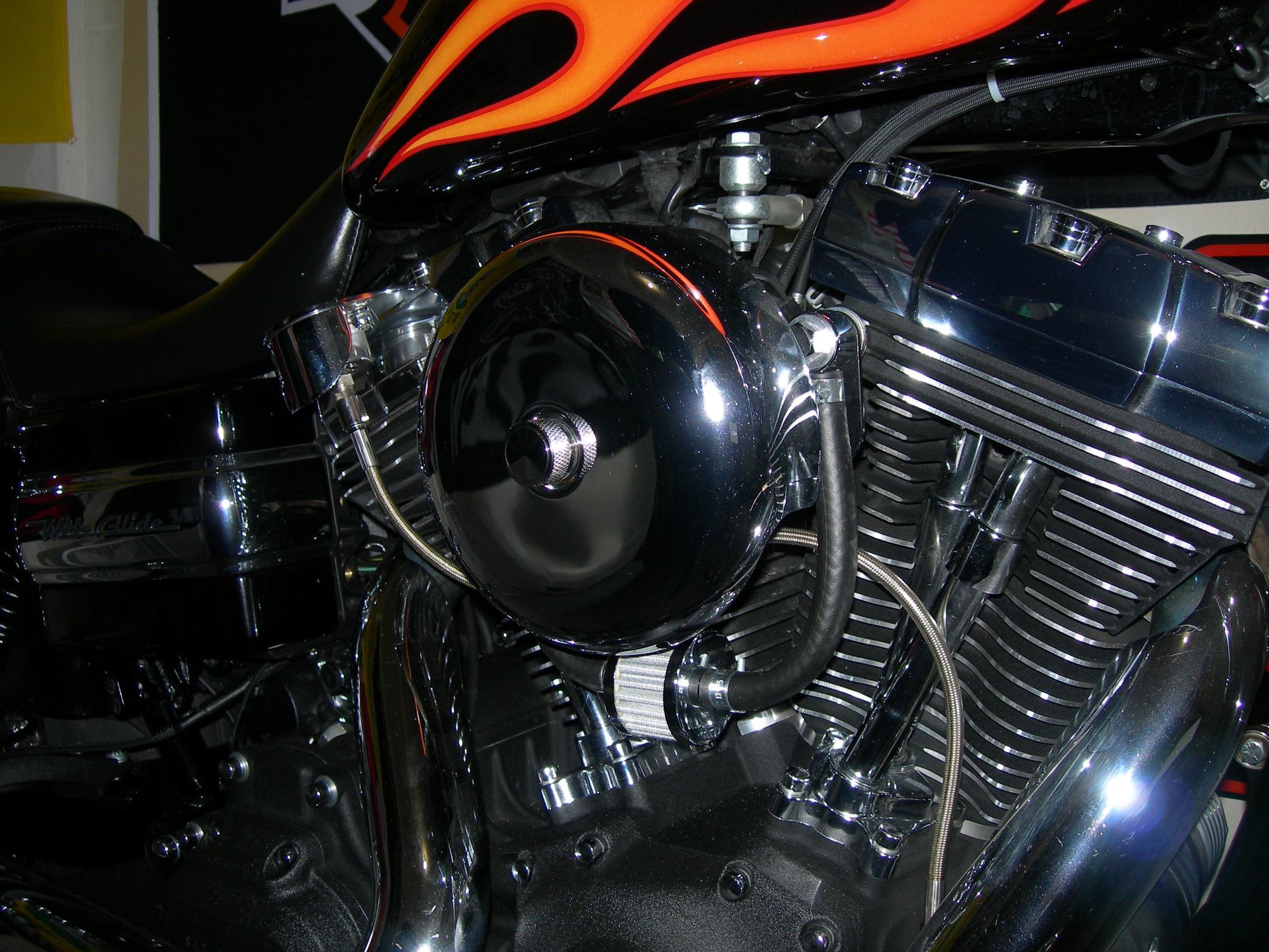

my hats what I'm doing on my lrs. I'm gonna drill and tap the stock heavy breather a/c and run the hoses to a splice running into the catch can, then just put a filter on the catch can outlet.
I did that to a Ness, a ventilator and to a few heavy breathers:
Ness - See post #22:
https://www.hdforums.com/forum/dyna-...l#post14658476
HD Heavy Breather (not trying to sell it - it's sold already):
https://www.hdforums.com/forum/dyna-...rnal-vent.html
See posts 8 & 10 for parts list:
https://www.hdforums.com/forum/new-r...l#post15701560

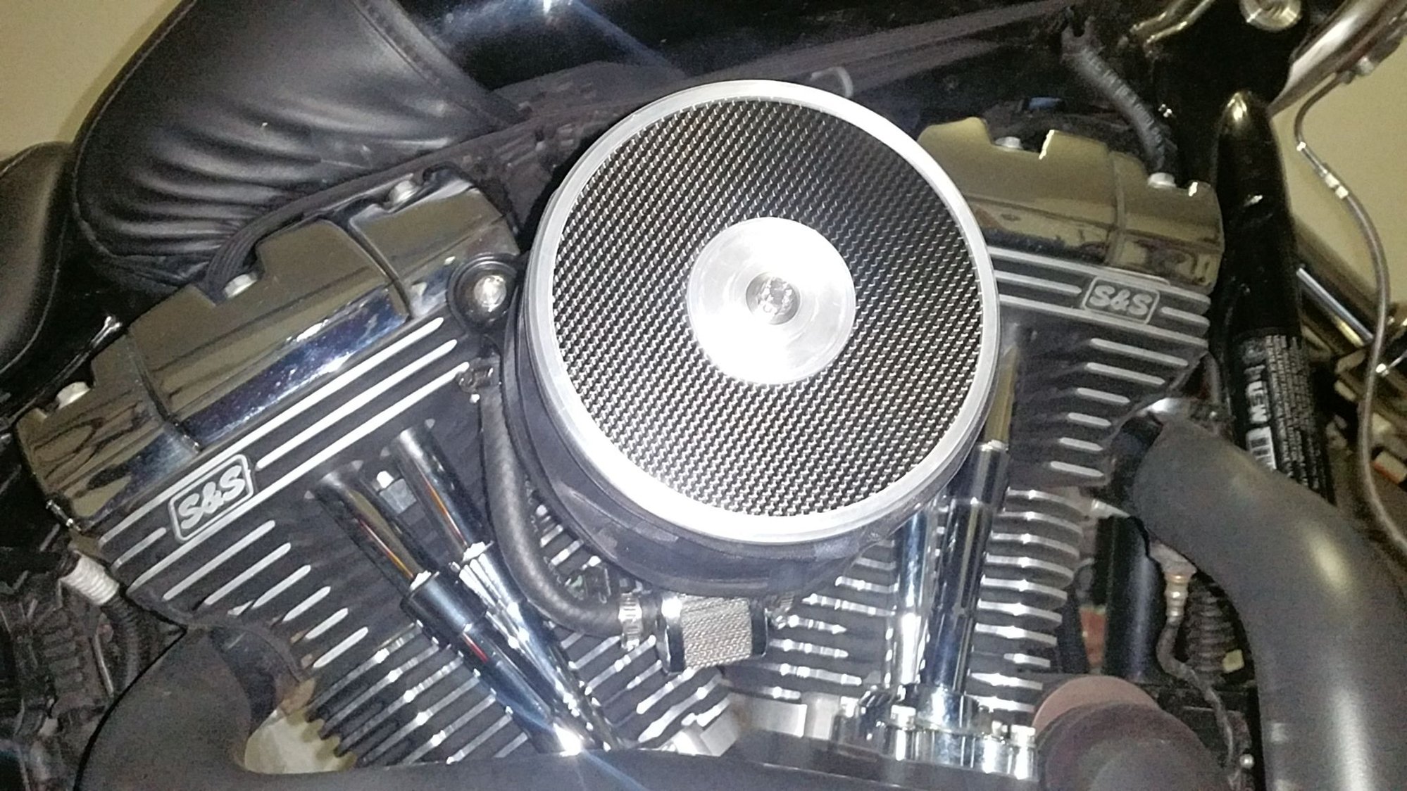

I have the big sucker on my bike. I replaced the breather bolts that came with the big sucker with 1 3/4" kuryakyn breather bolts and ran hoses to vent into a catch can. Here is the link for the bolts on Amazon and some pics.
This looks like the easiest and quickest way to try and solve the problem, besides just buying a new AC. I may just do this, thanks. Should I use a catch, or a filter? or both? What size/type of hose did you use?

my massacre based on MChads.... (he is not responsible for my destruction):
a.
b.

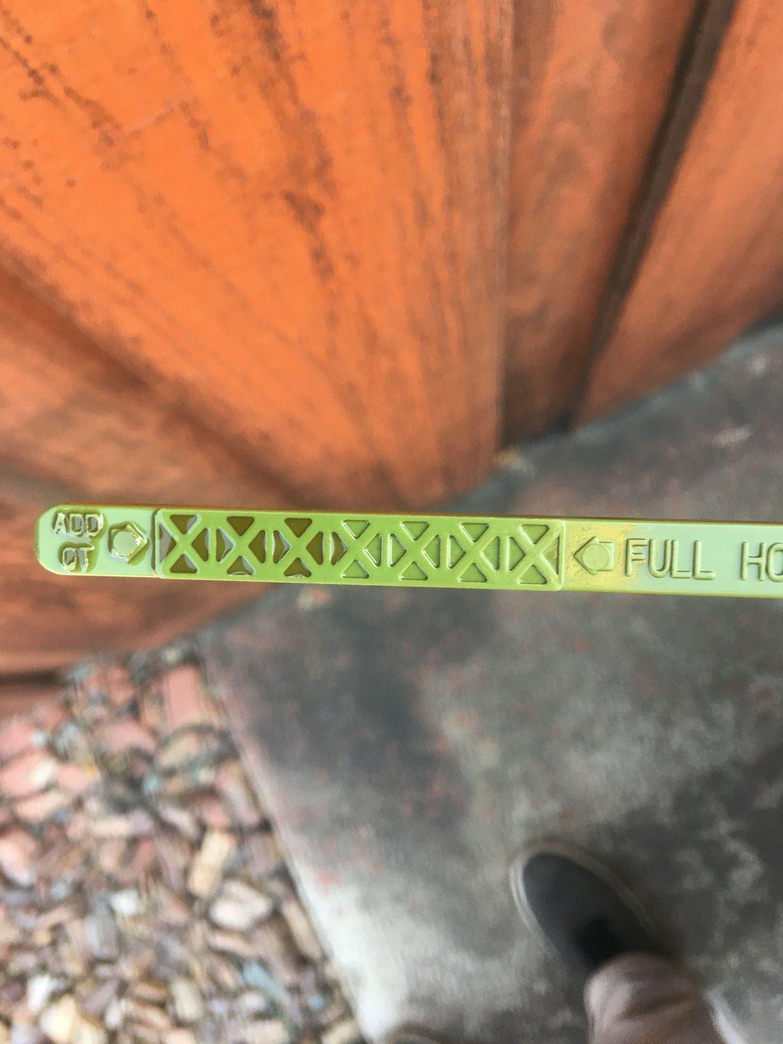

Thanks for the feed back, info, experience, links, etc gents. Here's a pick of my dipstick after a quick 40 min ride after work. Didn't puke all over, but there was light spray on the battery box, and drips forming under the AC filter.
