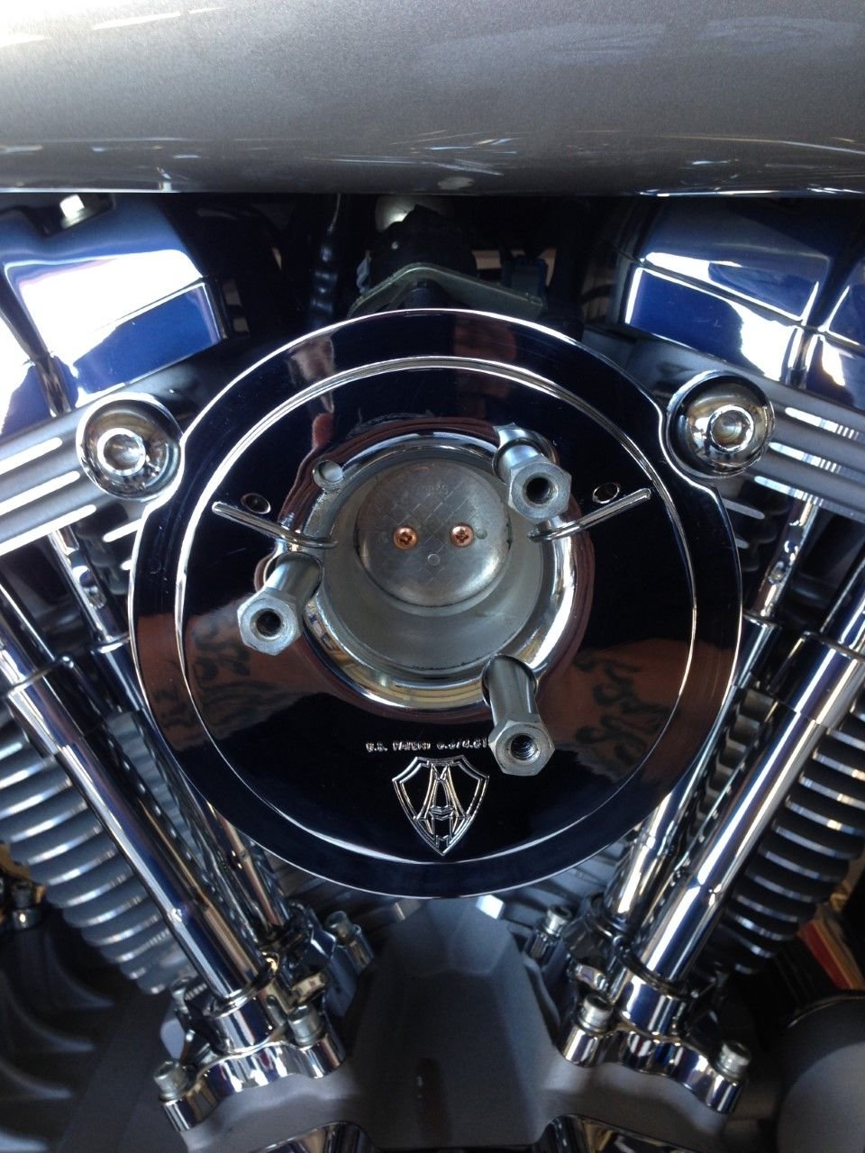

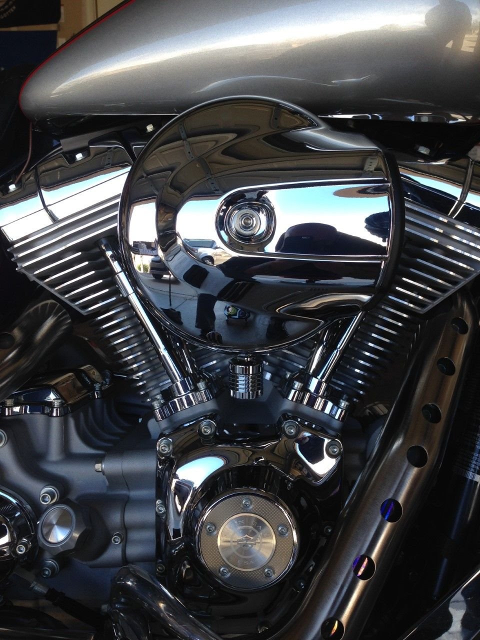

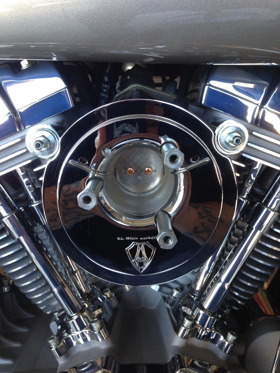

I have the big sucker on my bike. I replaced the breather bolts that came with the big sucker with 1 3/4" kuryakyn breather bolts and ran hoses to vent into a catch can. Here is the link for the bolts on Amazon and some pics.
Amazon Amazon
