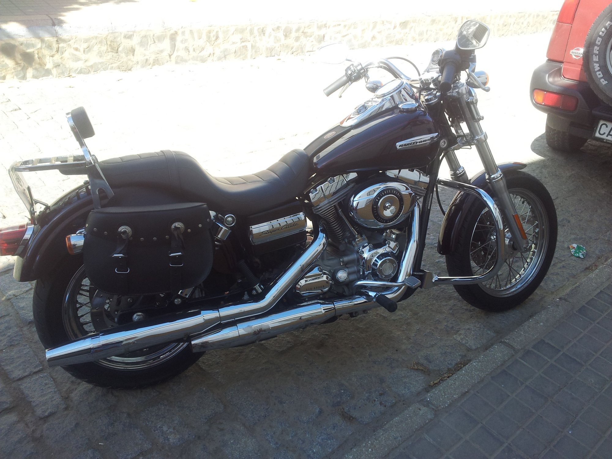

I had the silver engine, now its black, painted with duplicolor supertherm paint, I HATED the look of the silver engine besides it was a PITA to clean it.
Painted the engine at 6000 miles, now with 31k and holding just fine.

what the...!! HOW THE...!!!! Did you do this with the block in the bike?
So let me get this straight... you taped off each and every goddamn bolt and everything that WASN'T silver? How f'n long did that take?
Man - it looks absolutely perfect. Wish I could see this in perfect to get a closer look. Got any more detailed / close up pics you can post?

Yep, I did it when I bought the bike back in 2014, I even left the gas tank on, only removed the air filter, then tapped every single bolt and protected the frame, tank and any other thing with newspaper, then sprayed the engine with the paint, looking at it closely you can't tell that it was a silver engine, I even tried to paint under the frame , I did miss some small spots but meh, you can't see them unless you lift the bike up.
This was the day I bought it
The rest is just part of the process, I had pics with everything taped but can't find any right now.

Yeah that's mind boggling. I see the fin edges are half done - did you paint them, and then grind the paint off the edges afterwards?
Jesus I feel like it would be actually easier AND quicker to pull the engine and then paint from there.

Probably it would be easier, but not for me at that moment, it isn't that hard once you get at it, I think I took 2-3 days from start to finish.
The cylinder/head fins were done with a cloth and dissolvent, as long as you don't heat up the engine the paint doesn't harden and removes quite easily with any disolvent.

Wow. Amazing. So, when you're done with the paint, you basically start 'er up and when you do, the engine heat will cure the paint?

Yep, it gets hard as hell, I usually clean the bike with a high pressure water hose and I never had a small chip anywhere.
