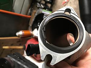

Arrow Finished the job.
I just got done fixing the bike today. Some parts took longer than others to come in.
I replaced the intake seals and also discovered that my choke cable was broken at the lever so I ran to my local HD and bought a new one for $14!
As you can see from the picture the seals were more than needed. I buttoned it up and set the idle along with the mixture screw. Ended up at 3 turns out with the idle set at 1000 rpm. I got one cough on the first start up and one more on the initial ride and that has been it. I let it sit for a while and came back to it. It fired right up and I went for another ride and it didnt cough at all
I did however forget to disarm the security system and sat there for a minute stumped as to why it wasn't starting
Overall I'm pretty happy with how it turned out. I hope the issue is gone for good but only time will tell. Thanks for all the advice.

I wasn't getting a cough problem like you describe but a backfire and decel popping issue that I chased back to the rear intake flange seal. It took a couple of tries to get it all back together with no leaks. I found this technique in a forum discussion and it works like a charm: Put it all together including the air cleaner back plate and carb finger tight only. Then walk all the fasteners down snug tight together then set the final torque.
A set of long ball-end Allen wrenches are a must for a Harley toolbox. Cut off the short end of a regular 1/4 inch Allen wrench to get at the left side intake flange screws.
